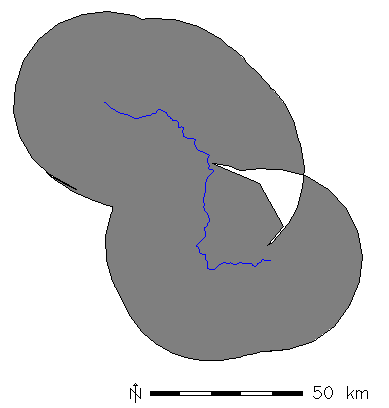

Hi
Please see the attached screenshots. These are supposed to be the 30km buffers for the 'odra_glogow_brzeg_cl' (blue), a vector line, topologically clean for sure.
Why are the buffers so awfull? There isn't anything special about my input data or whatever. Any guess?
The vbuffer.png was made with 'debug=buffer':
v.buffer input=odra_glogow_brzeg_cl output=odra_glogow_brzeg_cl_buf30
type=line layer=1 buffer=30000 tolerance=0.01 debug=buffer
GRASS_INFO_MESSAGE(20920,1): The tolerance in map units: 300
Lines buffers ...
Rebuilding topology ...
Building topology ...
Registering lines:
1 primitives registered
Building areas:
1 areas built
1 isles built
Attaching islands:
Attaching centroids:
Topology was built.
Number of nodes : 1
Number of primitives: 1
Number of points : 0
Number of lines : 0
Number of boundaries: 1
Number of centroids : 0
Number of areas : 1
Number of isles : 1
Number of areas without centroid : 1

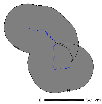

And vbuffer2.png made with debug=clean:
type=line layer=1 buffer=30000 tolerance=0.01 debug=clean
GRASS_INFO_MESSAGE(21567,1): The tolerance in map units: 300
Lines buffers ...
Building parts of topology ...
Registering lines:
Topology was built.
Number of nodes : 1
Number of lines : 0
Number of areas : -
Number of isles : -
Snapping boundaries ...
Registering points ...
All vertices: 117
Registered points (unique coordinates): 116
Nodes marked as anchor : 116
Nodes marked to be snapped : 0
Snaps: 0
Snapped vertices : 0
New vertices : 0
Breaking boundaries ...
Intersections: 0
Intersections: 22
Removing duplicates ...
Duplicates: 0
Duplicates: 1
Duplicates: 2
Duplicates: 3
Duplicates: 4
Attaching islands ...
Building areas:
5 areas built
0 isles built
Attaching islands: Topology was built.
Number of nodes : 12
Number of primitives: 36
Number of lines : 0
Number of boundaries: 36
Number of areas : 5
Number of isles : 0
Number of incorrect boundaries : 14
Number of areas without centroid : 5
Registering lines:
24 primitives registered
Building areas:
5 areas built
0 isles built
Attaching islands: Attaching centroids:
Topology was built.
Number of nodes : 16
Number of primitives: 24
Number of lines : 0
Number of boundaries: 19
Number of centroids : 5
Number of areas : 5
Number of isles : 0

v.buffer is buggy, try 2x15000.

v.buffer is buggy
try 2x15000

Do you mean making one buffer of 15000 and then buffering this buffer once more with 15000? What is the max buffer limit BTW?

Yes. Thi limit is where it does not work.
