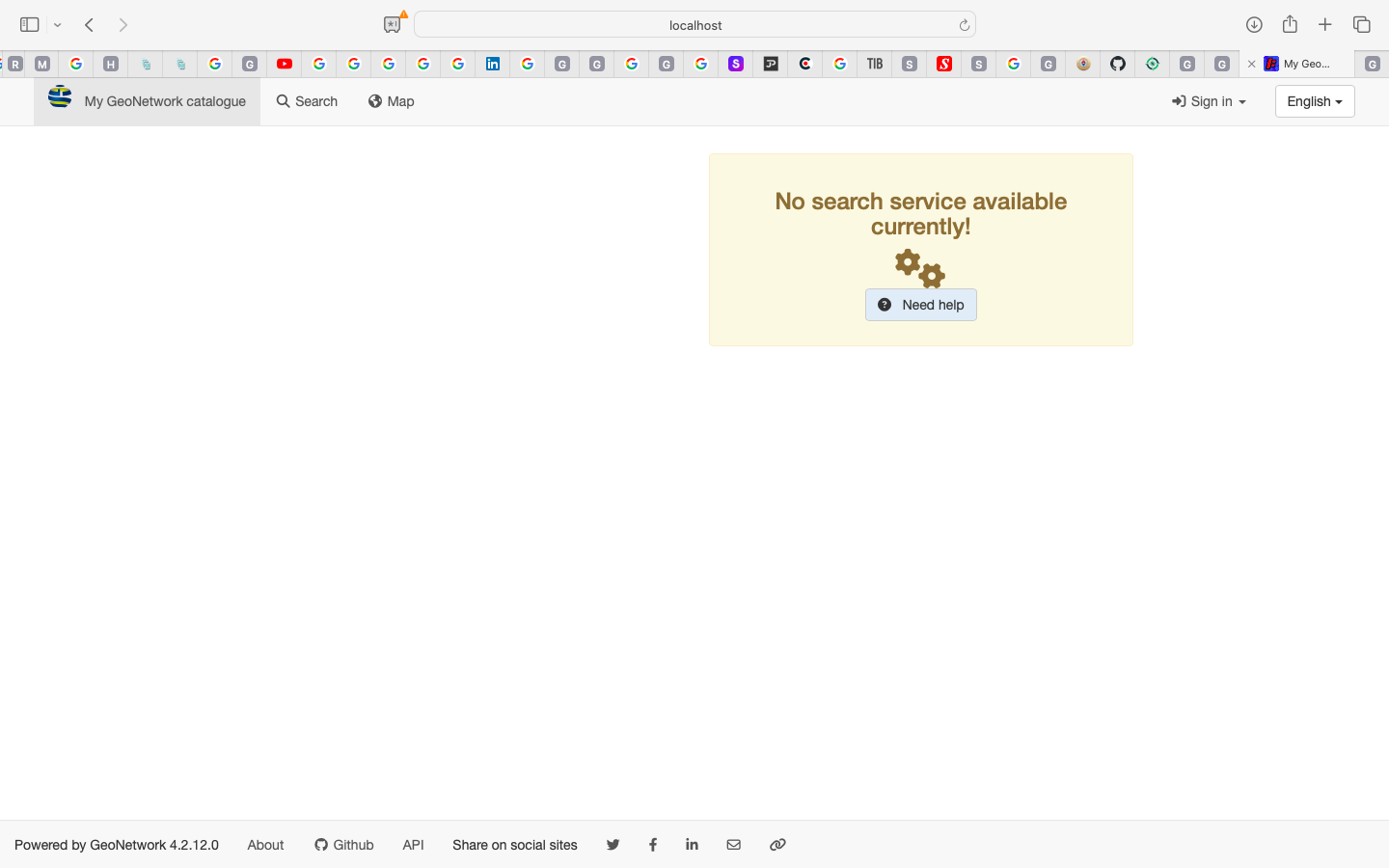

Hi,
This is a screenshot of my browser after I have run the same commands as above in my previous post in Docker Desktop itself.
I am going to refer to the user guide, but does this home page look correct ?

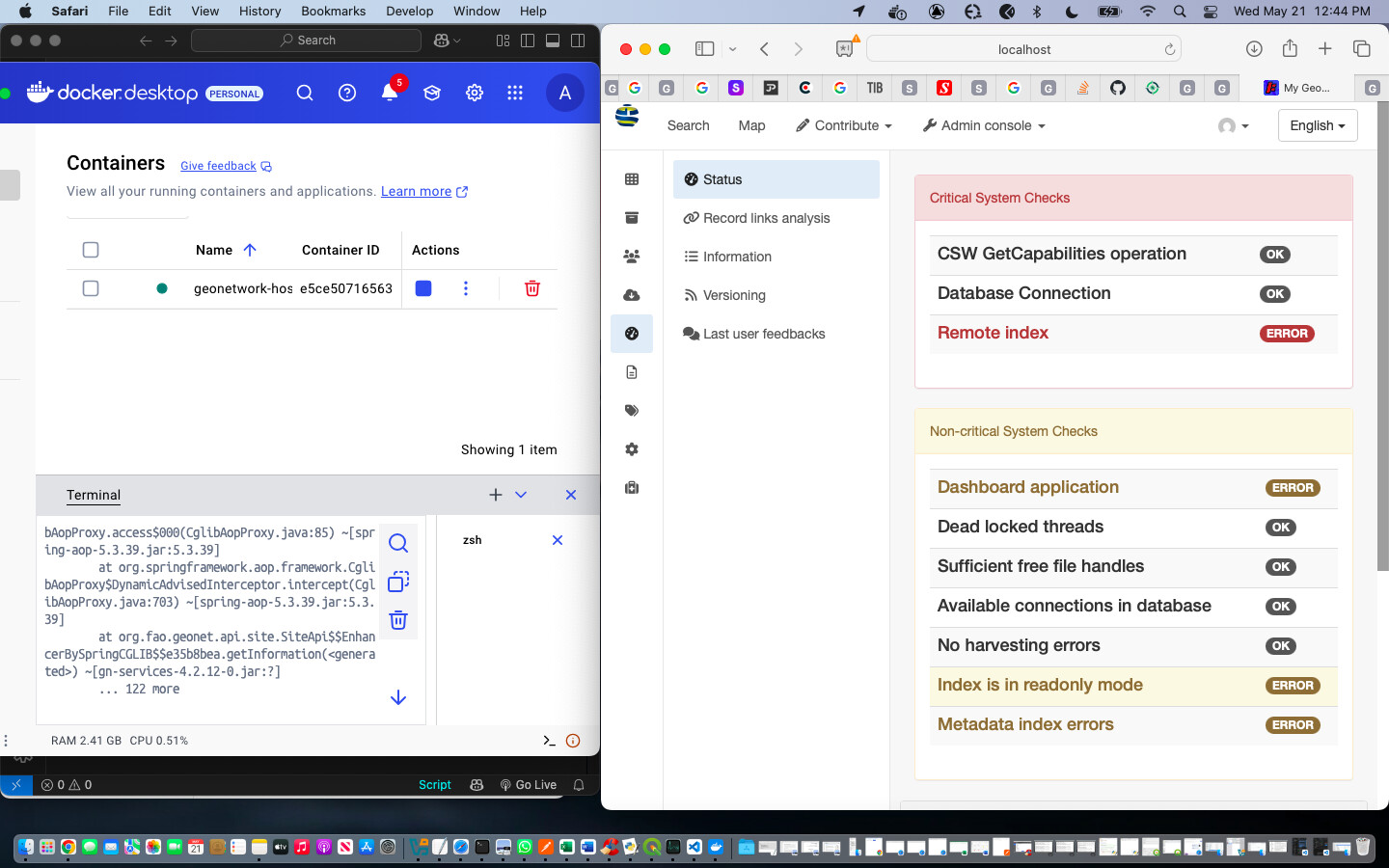

Hi,
Please see the relevant screenshots below:
Is elastic search the client / host for the Jetty server ?
If not, there are directories that point to Jetty while the Index information at the bottom refers to an elastic search server.
Andrew
As you can see, there are also all kinds of system checks that have errors ??
Seems there are some issues with your network.
Try to reach your ES image on localhost, do a CURL, test it before running GeoNetwork.
