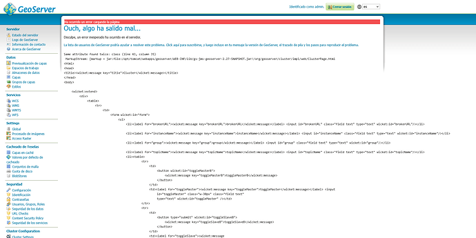

Hi GeoServer Community,
While deploying GeoServer, and adding the JMS Cluster extension, we found that
the Cluster settings Section does not show the settings properly.
While the functionality of the extension in itself is not affected(replication still works),
it is strange that the extension for other versions(2.26.x) does work without problems.
Setup Details:
GeoServer Version: 2.27.1
JMS Cluster Extension: geoserver-2.27-SNAPSHOT-jms-cluster-plugin.zip
Java Version: 17.0.15
OS: Red Hat Enterprise Linux 9.4
Everything else is as is , we left GeoServer to configure everything,
Error Log

31 Jul 08:56:57 ERROR  [markup.MarkupFactory] - Error while reading the markup jar:file:/data/apache/tomcat/instances/lsig-ws01_ap03/webapps/geoserver/WEB-INF/lib/gs-jms-geoserver-2.27-SNAPSHOT.jar!/org/geoserver/cluster/impl/web/ClusterPage.html
Same attribute found twice: class (line 43, column 35)
 MarkupStream: [markup = jar:file:/data/apache/tomcat/instances/lsig-ws01_ap03/webapps/geoserver/WEB-INF/lib/gs-jms-geoserver-2.27-SNAPSHOT.jar!/org/geoserver/cluster/impl/web/ClusterPage.html

Caused by: java.text.ParseException: Same attribute found twice: class (line 43, column 35)

Here is an image of the error:

The HTML page really has the class attribute repeated multiple times, in various elements, see here:

Hi Andrea,
thank you for pointing out the error, I completely missed it!
After modifying the HTML file, the extension worked correctly.
