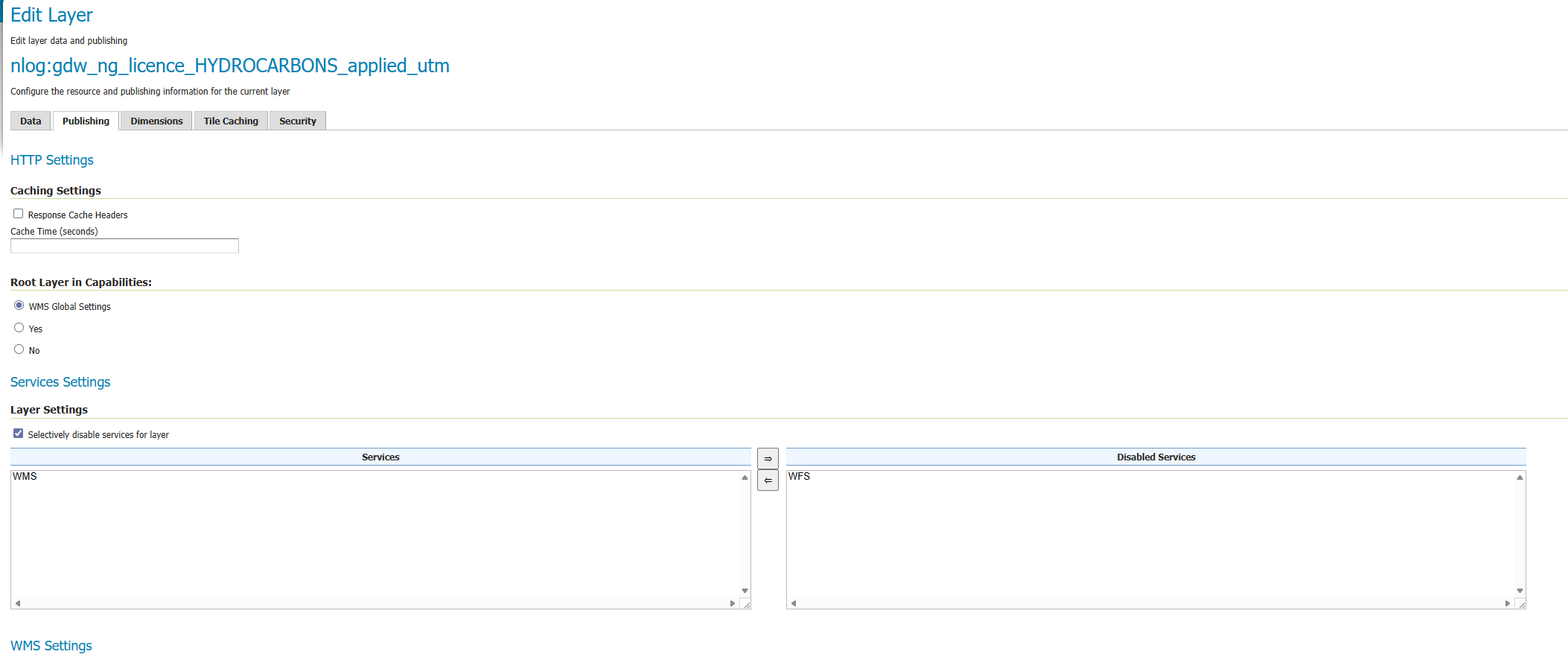

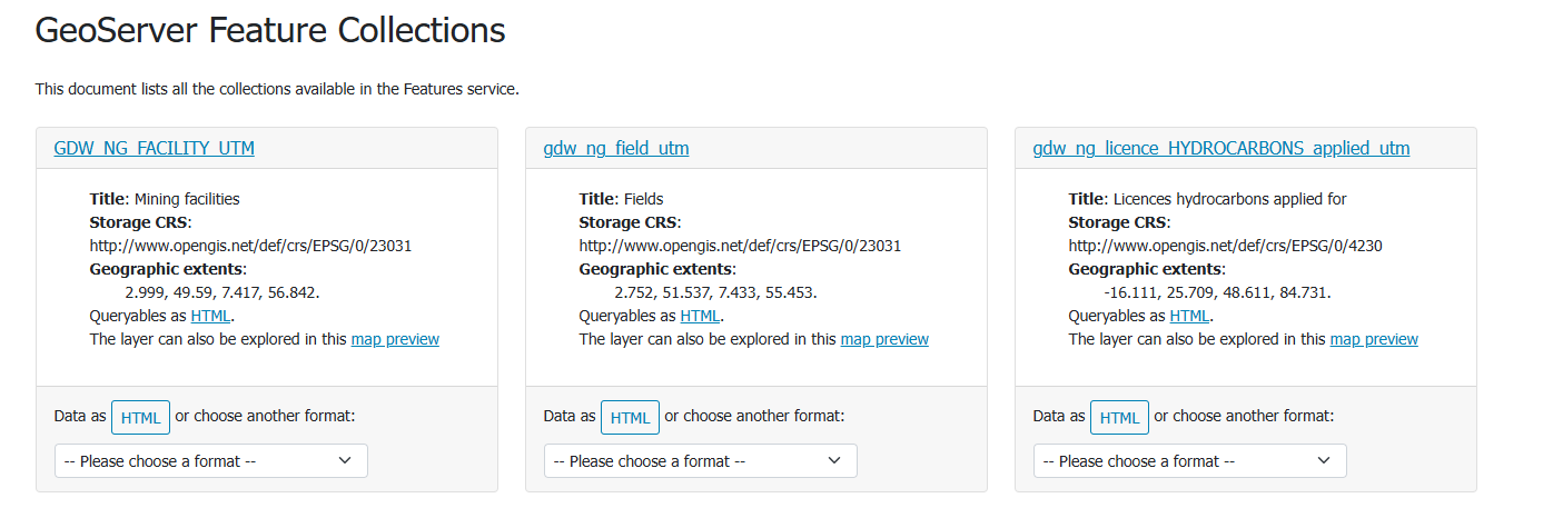

Was wondering why OGC Features API layers show up which have been set to WMS-only through selectively disabling WFS service?
I would have expected it to follow suit with the WFS config in this instance, but it still shows up in the collections and it doesn’t matter if accessed via the global endpoint or via the workspace specific, and doesn’t matter if the workspace is isolated or not!

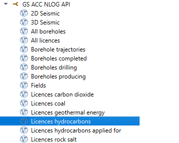

Outcome is that the user is shown a layer which they can’t load, which then trips QGIS into hanging and then eventually crashing.
