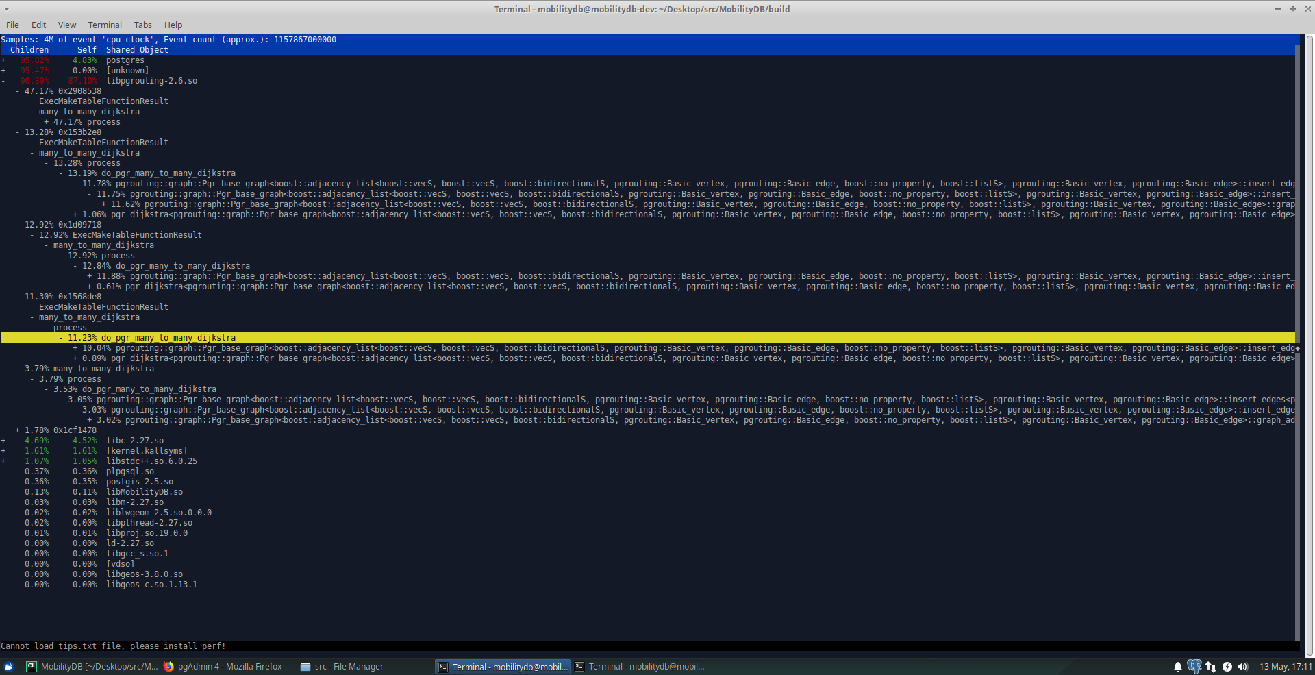

    We have done a first profiling of these data generators and
    realized that 87% of the time is spent in pgrouting building the
    graph thousands of times, at each query sent to pgrouting. On the
    other hand, the real work of MobilityDB only accounts for 0.11%
    For this reason we would need an API in which we build the graph
    once at the beginning of the simulation, send to pgrouting
    thousands of calls to pgr_dijkstra, pgr_aStar, pgr_dijkstraVia,
    etc. and then delete the graph, free the memory and start the
    simulation.
    Any idea how to achieve this ?
    Many thanks for your valuable help.
