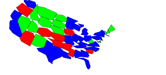

Very very cool.
I am experimenting with the reprojection capabilities, and got
something interesting:
http://localhost:8080/geoserver/wms?bbox=-4578324,2500333,3189008,6611929&styles=population&Format=image/png&request=GetMap&layers=topp:states&width=550&height=250&srs=EPSG:42104

Hi,
I fixed this - the decimation code uses the lowerleft (0,0) pixel to determine scale for generalization. I modified it to so it uses the middle of the image (and added a set of java dox for other improvements). See the attached image.
I've also attached the modified jar, you should find the location of the old gt2-render.jar file and replace it with this. You might have 2 of these jars in your install; replace both. Make sure you replace the one in WEB-INF/lib.
Restart your servlet container and make the request again - you should see the same thing as the attached picture.
dave
ps. your original image sure does look like something an artist would create!
pps. thanks for trying out the new geoserver and giving feedback - keep it comming...

On 5/9/06, David Blasby <dblasby@...1...> wrote:
Hi,
Snap!! So no new waterfronts.
Thanks for the prompt fix,
Alex
