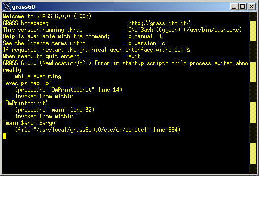

Thanks. Eventually, I input the Location manually by entering x, y(giving up creating Location from EPSG). However, after restarting the GRASS and “Enter GRASS”, the Grass interface flashed out and then disappeared. The following error is appeared as attached. Do you have any idea what is the problem? Did I set anything wrong?
Thanks in advance.
Raymond

after restarting the GRASS and "Enter GRASS",
This problem is being continously reported for Grass 6.0 in Cygwin.
Switching to Grass 6.1 CVS should fix that.
Please consider browsing mailing list archive first - this issue has
been discussed several times.
Maciek
