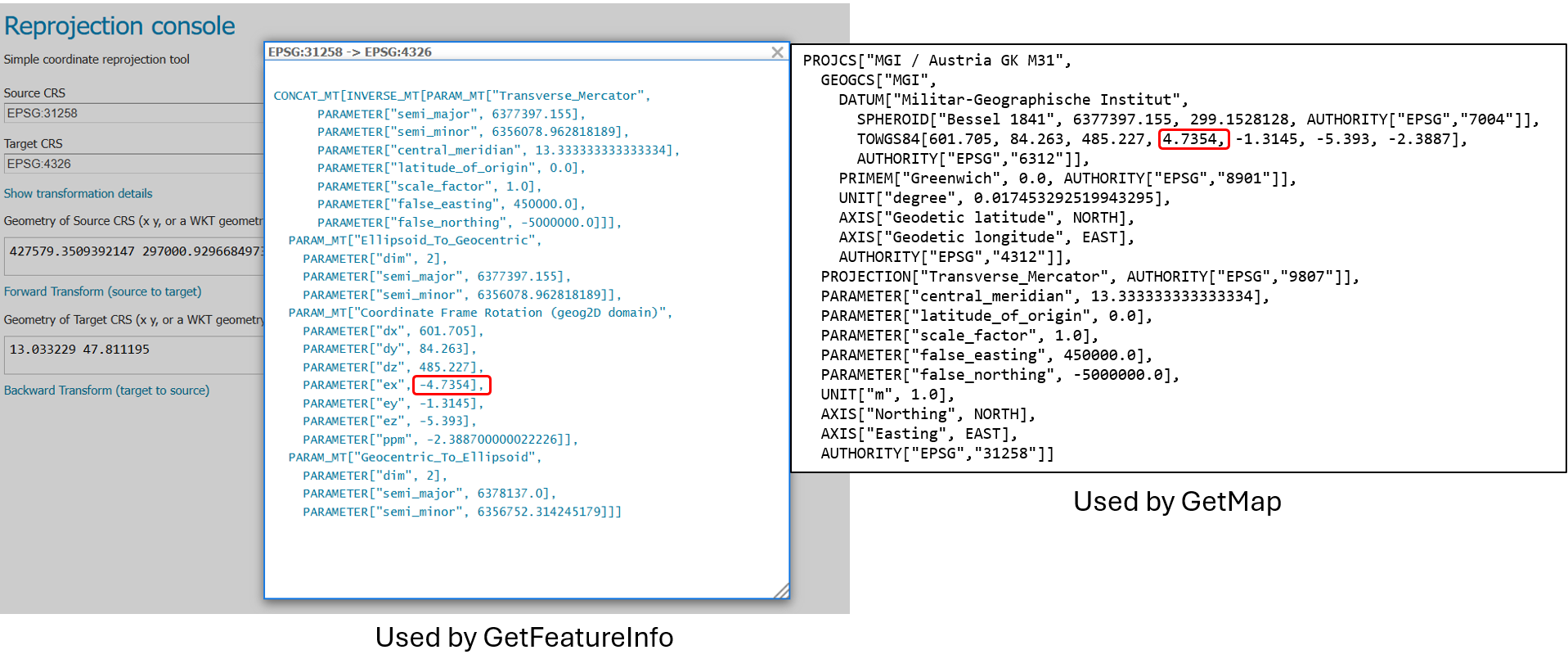

Hi, thanks a lot Andrea. We can confirm this issue remains in new versions (tested on 2.27.1 and a recent 2.28 nightly). And setting -Dorg.geotools.referencing.operation.order=AreaFirst does fix the issue. But there does seem to be an underlying bug in the original transform code. In the image below you will see the different signs in the CFR ‘ex’ parameter and the 4th TOWGS84 parameter. We plan to make a PR for this when we get chance. This also affects some CRSs outside of Austria, e.g., we saw it in a Portugal CRS too.
For reference, there is a draft PR here with a potential cause of the issue, but the fix is not yet tested: [GEOT-4962]: Fix Coordinate Frame Rotation transforms [WIP] by lukesdm · Pull Request #5529 · geotools/geotools · GitHub.
