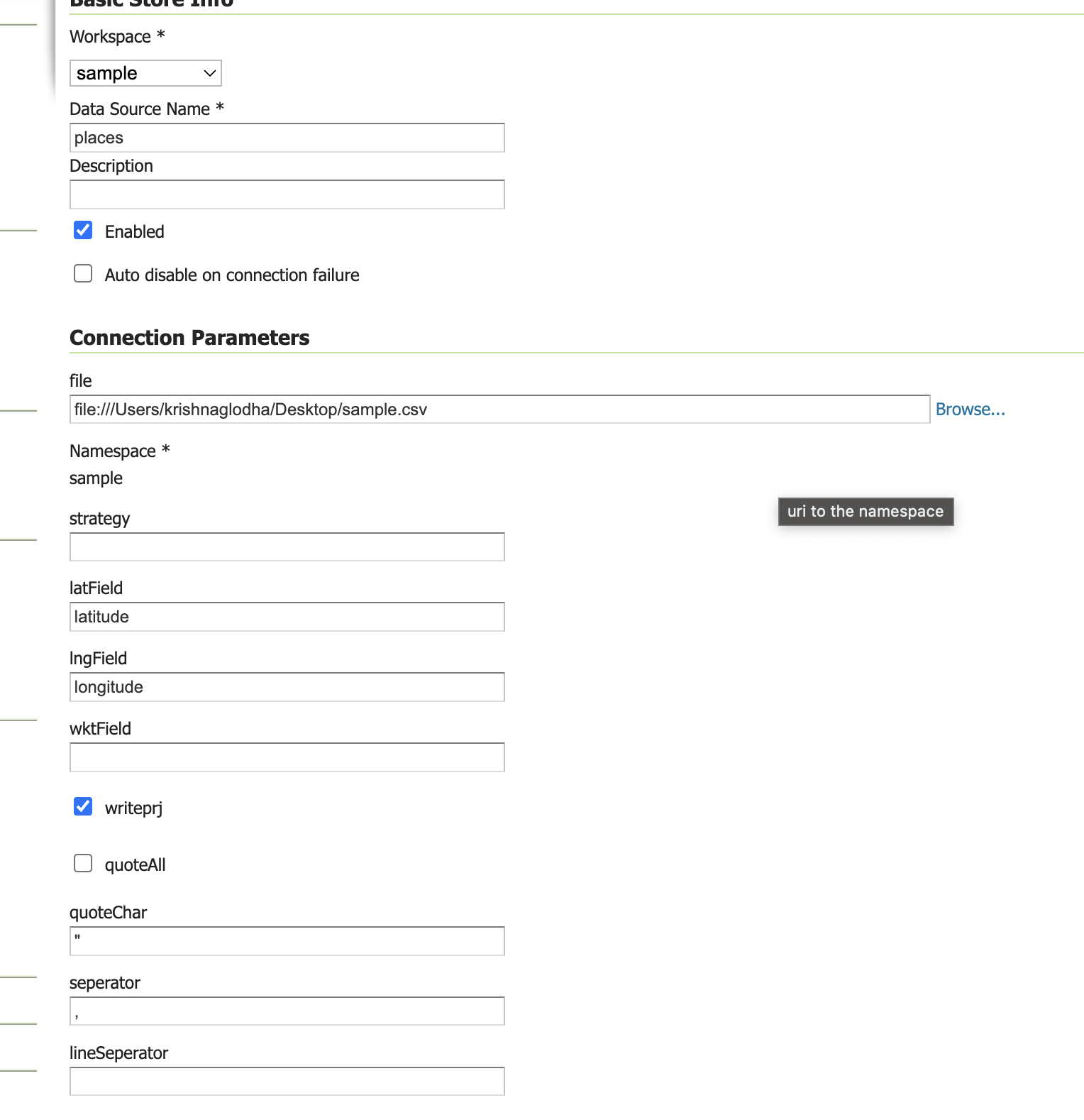

I have a CSV file with columns for latitude and longitude, and I want to create a layer from it. On the Store page, I can see the option for CSV.
While setting it up, I am configuring everything except strategy.

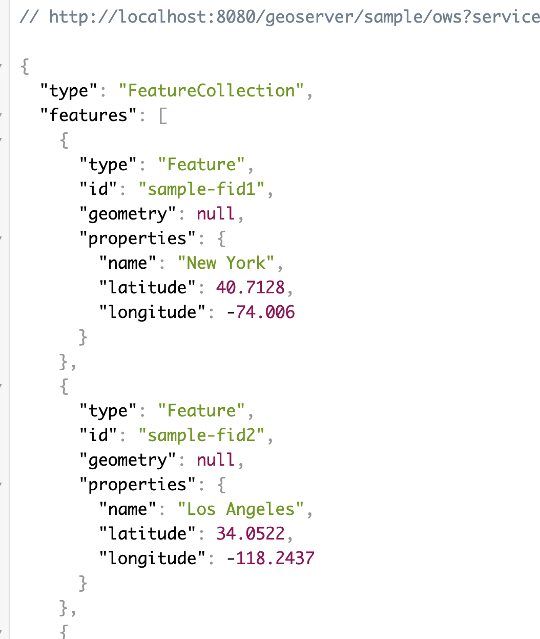

However, the layer is not generating the geometry correctly. In the GeoJSON response, all other data is loading properly, but the geometry is null.
I think you may wish to say the stratagy “ specify ” so it knows to try that lat and lon field.

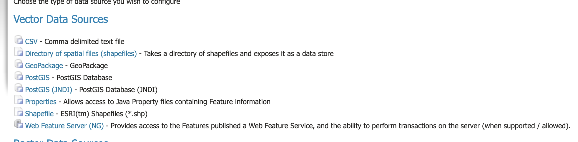

That said I wanted to check the situation. I don’t see the CSV store anywhere in the stable series, not as core, nor as an extension. It is however included when installing the WPS and importer extensions, as a way to parse and encode CSV files. Two legit cases, where the CSV is processed one time and turned into something else.

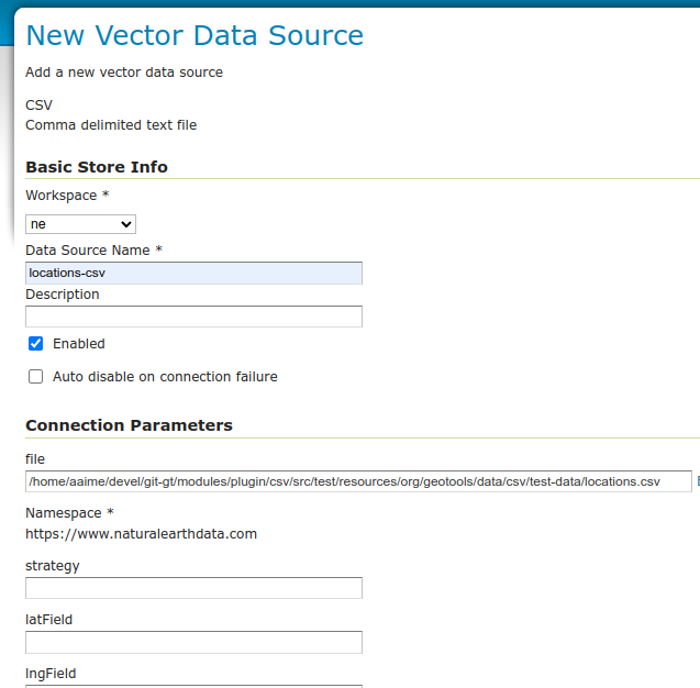

The inclusion has the side effect of having the CSV store show up also in the “new data store” page. The experience configuring it is indeed not great:

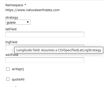

The strategy bit could be improved… it’s an enumerated field with possible values guess, AttributesOnly, specify, wkt.
When not specified the default is “AttributesOnly”, which is not going to guess any geometry type. “guess” may seem a better default, it will try to guess which columns are lat and lon (but won’t try to guess a wkt approach).
For the small data set I’ve chosen, “guess” will work:
