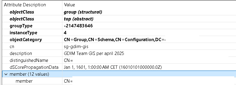

I’ve correctly configured the User lookup and the Group lookup, so we have both of those working fine. It’s just the mapping between that I can’t seem to get working, would be very grateful for any advice?
Group has a member attribute which is the DN for the user.
It’s not immediately clear whether this evaulation is performed group→user or user→group and I can’t see that in the documentation.
I’ve tried all of the below permutations for both directions, we are using Microsoft AD
