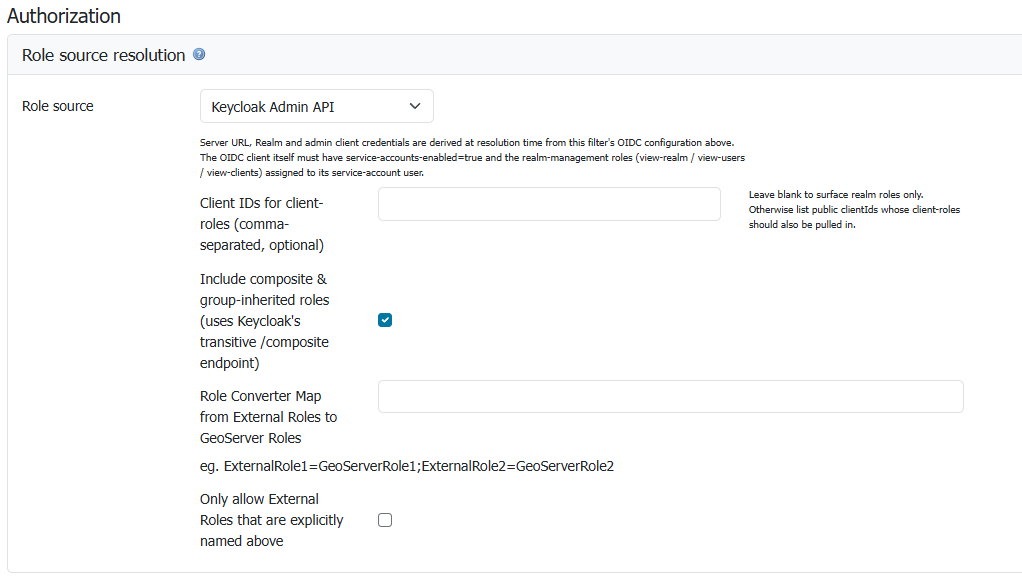

I’ve put together a PR for this. The new OIDC plugin now offers a KeycloakAPI role source that calls Keycloak’s Admin REST API and resolves the user’s effective roles via the …/role-mappings/realm/composite (and optional …/role-mappings/clients/<cid>/composite) endpoints — so users inheriting roles through groups are now picked up correctly, which addresses the original issue from this thread.
Configuration is intentionally minimal: the Keycloak server URL and realm are derived from the OIDC discovery URI, and the OIDC client credentials are reused for the admin call (the admin client needs view-users, view-clients, view-realm granted as service-account roles). Composite resolution is on by default; an optional CSV lets you include client-roles from one or more public clients.
End-to-end tested against Keycloak 26 with a five-user fixture covering direct, composite, and group-inherited assignments; Testcontainers integration tests included; docs and screenshots updated.
One scope note: this PR addresses the runtime authorization gap from your original report. The broader role-service port discussed later in the thread — synchronizing the catalog of available Keycloak realm + client roles for administrators to pick from in the workspace/layer ACL UI — is intentionally out of scope here. The Admin REST API helpers added in this PR (URL builder + role-mappings client) are reusable for that piece if you’d like to contribute it as a follow-up; happy to review.
