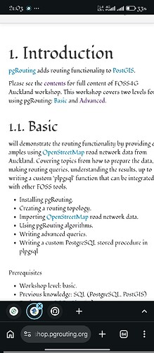

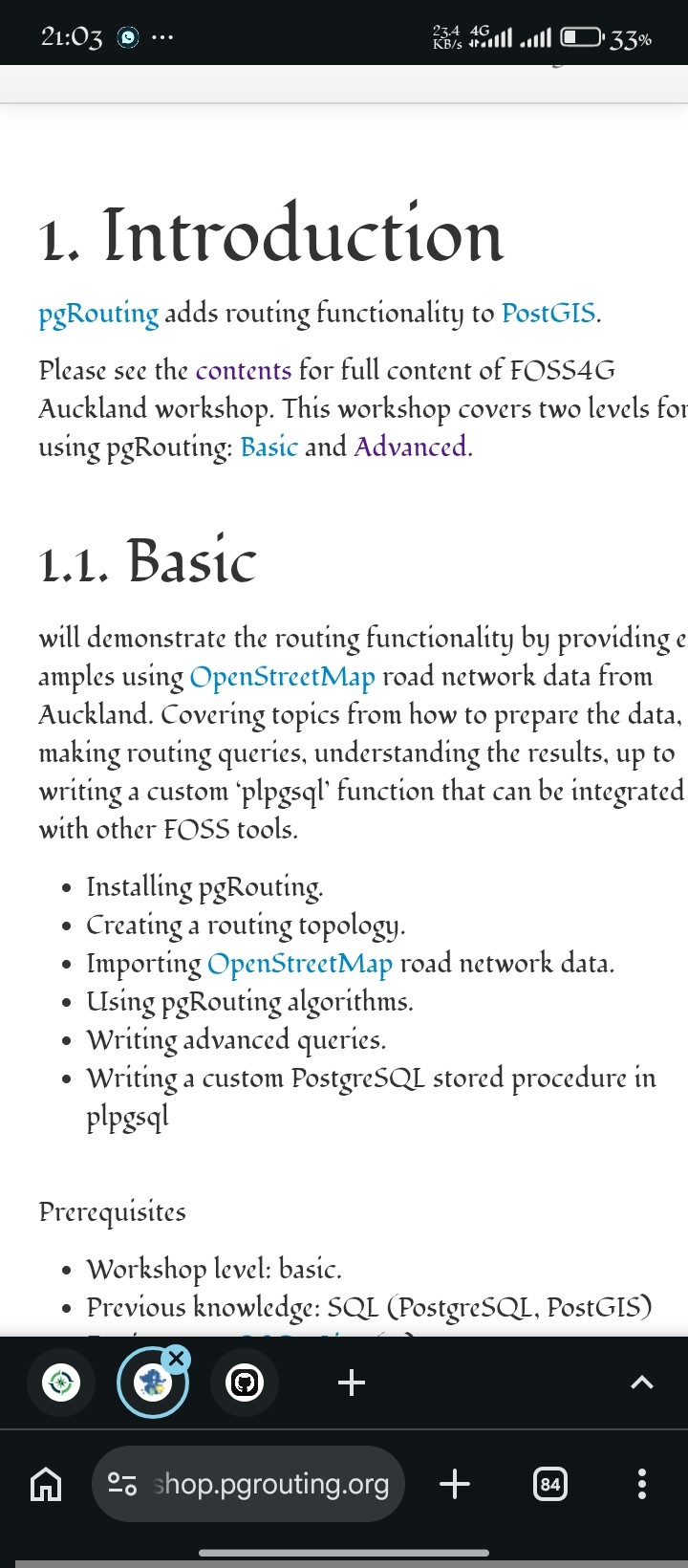

I started going through the workshop documentation and noticed a small typo in Section 1.1 (Basic). The opening sentence starts directly with ‘will demonstrate…’ and seems to be missing its subject. I think adding ‘This section will’ or ‘This level will’ would make it much clearer for a user following along.
Ah great catch. @cvvergara is it okay if @Fawaz-Lawal starts a pull request for things he finds or you prefer he wait until you’ve made some restructurings.
Hi all
Especially the mistakes and Grammar fixes are welcome

Thank you for the warm welcome. I’ll get right on fixing those typos and grammatical mistakes in the documentation and open a Pull Request shortly for your review.
Hello everyone
I just opened a pull request and await your review. @cvvergara @robe
I see @cvvergara merged. Great first contribution - fix workshop typos by Fawaz-Lawal · Pull Request #276 · pgRouting/workshop · GitHub
