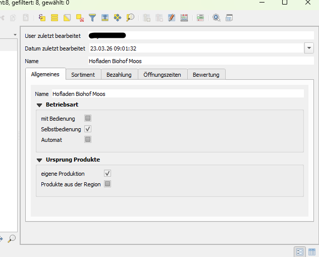

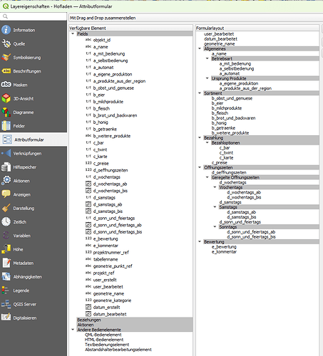

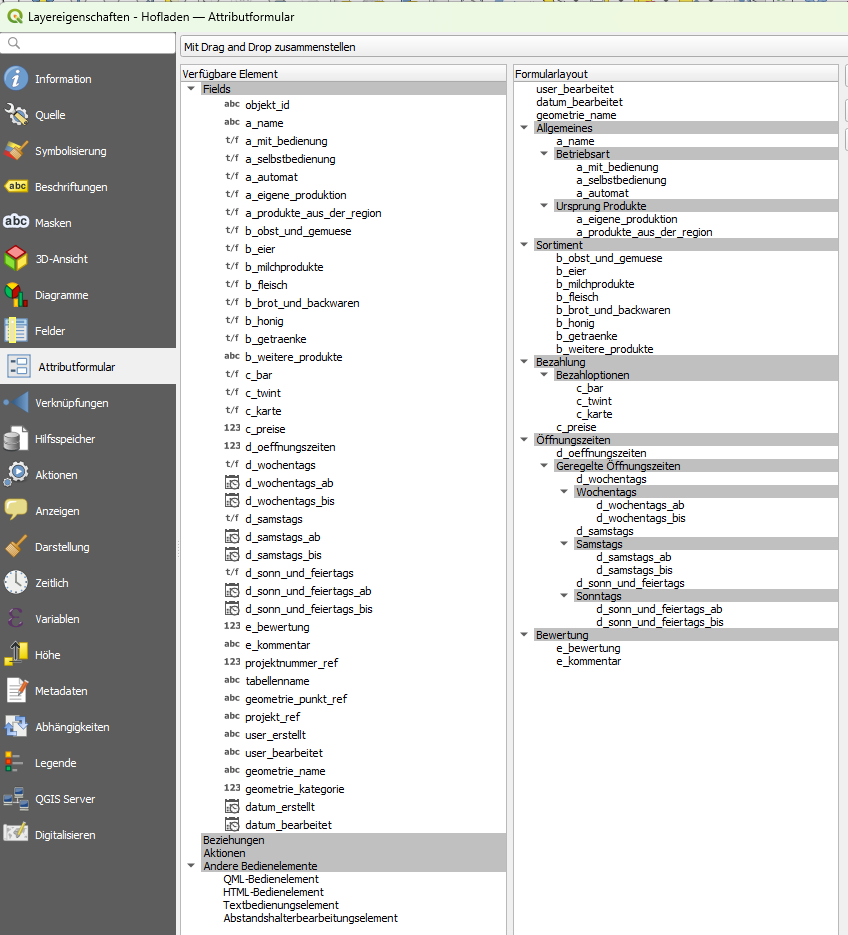

In QGIS we have with the support of styles / .qml file designed the attribute form as follows:

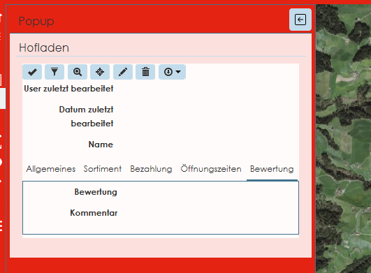

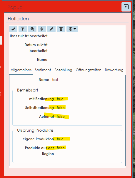

When I click on an object in the Lizmap Webbrowser view I get:

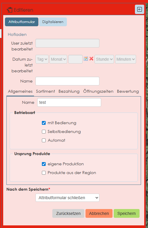

When I enter into the edit mode in the same session I get the layout similar to the previously shown layout in QGIS:
How can I get this view of the attributes (edit mode) as standard view in non-edit mode for all users?

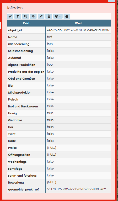

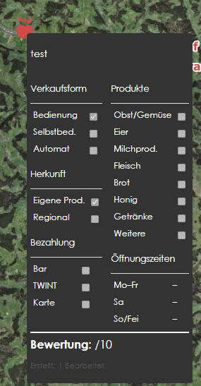

the popup - with hovering over an object - is already designed as follows:

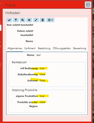

Thanks a lot for the immediate support! It works better now:
but it does not look like in the edit mode:

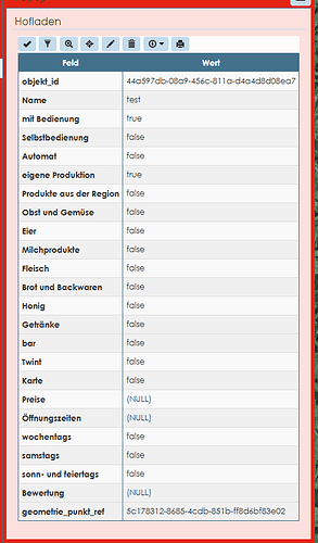

This is the “normal” (non-edit) view:
This is the view in edit mode:
how can this be fixed?

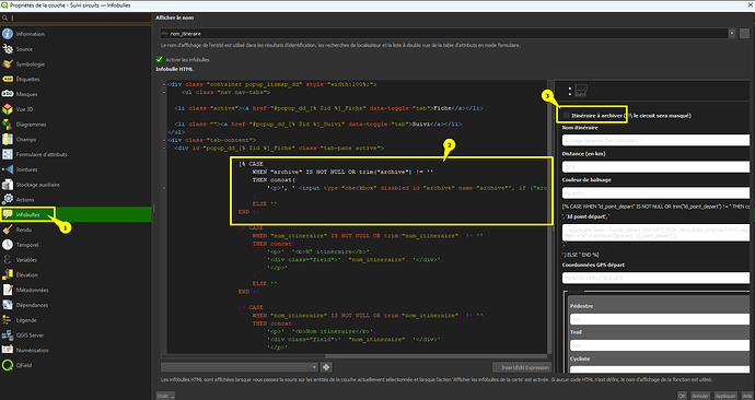

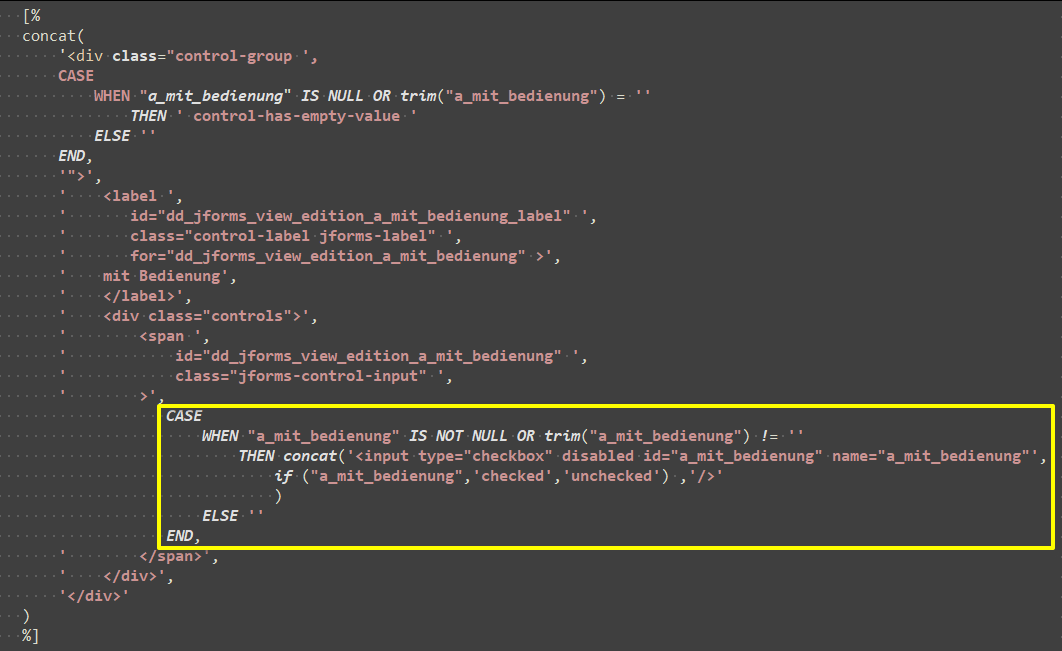

You can modify the HTML code in the maptip using :
<input type="checkbox" id="xxx" name="yyy" value="zzz" />
where you can control the state checked or unchecked.
For example :
[% CASE
WHEN “archive” IS NOT NULL OR trim(“archive”) != ‘’
THEN concat(
‘’, ’ <input type=“checkbox” disabled id=“archive” name=“archive”‘, if (“archive”,‘checked’,‘unchecked’) ,’/> Itinéraire à archiver‘,’’
ELSE ‘’
END %]

but it seems it IS already implemented: in the edit view it is as I would expect it - but just in the view mode it does not show as expected (with the true/false values instead of the checkboxes). It would just mean: in the view mode show the same layout as with the edit mode just without writing access
Yes, in the edit view, it is already implemented but in the view mode, it’s different because it is the maptip html code which is used.
So, you have to open the layer properties > go to the maptip > and modify the HTML code with the example i give you earlier.
Here :

If I went this way I would lose all the nice layout / organisation of the fields in different tabs… so this is no real alternative. I cannot understand why the view mode should be any different or even “worse”/less sophisticated than the edit view ??
No ! You must keep all the nice layout organisation of the fields in different tabs.
You just need to customize a part of the HTML code to change the true/false attribute shown as a text field today by a checkbox…
We are just trying to help you, we can’t justify lizmap code.

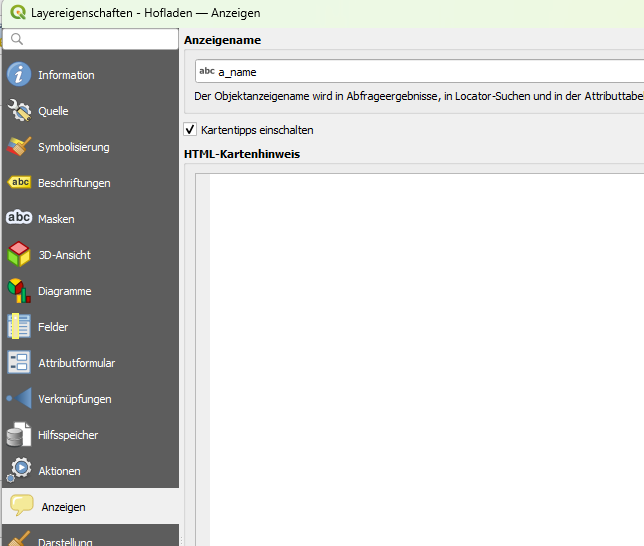

When I go to the settings of the layer I do not have the code of the tabs (which we defined via a qml file) :
like this:
does that make sense / help?
OK. This maptip is empty because you use the layer’s pop-up to QGIS Drag & Drop Form Popup.
If you want to customize this code, as i said in my first answer this morning, you need to use the “Maptip HTML QGIS” popup int Lizmap module, then, click on “copy drag and drop form” and then modify the maptip HTML code.
If you change the layer’s popup in the lizmap plugin to QGIS HTML maptip and then Copy drag n drop form layout it will “convert” your drag n drop layout into html - which enables you to add some custom html to your layout.

You can test with this code :
lizmap_att_view.html (52.8 KB)
For each boolean field, I change the simple value by a checkbox :
Before :
After :
I think it will be OK.

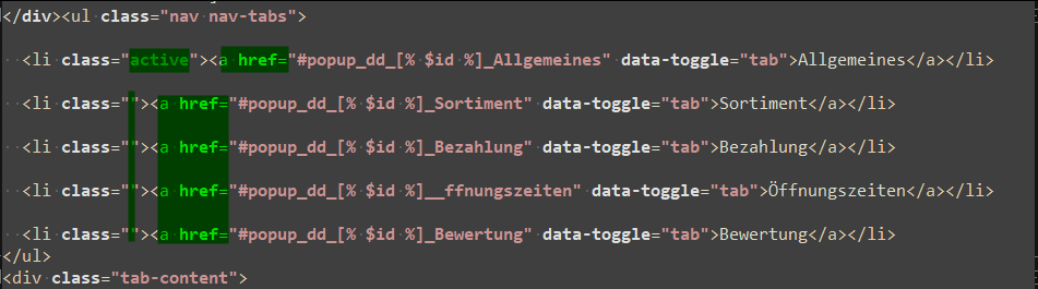

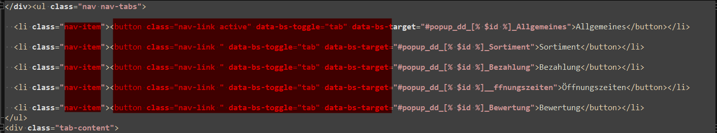

the looks are ok - but when I click on one of the tabs (“Allgemeines”, “Sortiment”, “Bezahlung” …) nothing changes - in other words: the clicked/selected tab does not open, it remains on the first…
Ohhh ! I have the same problem on all my projects for months but i tought it was from my personnal CSS so i have’nt written any issue ticket.
You can try with this new code :
lizmap_att_view.html (52.5 KB)
And I will open an issue on github to perform this solution.
To correct this bug, i have replaced button class=”nav-link” by some link balise “a href” like this :
Before :
After :
fix for the checkbox - popup issue is on the way
I’m working on the not-selectable tabs right now, i ran into that problem as well ages ago and just did not really bother /switched to automatic form view, good of you to raise the issue @Hans-Joerg & @Alain-LG !
