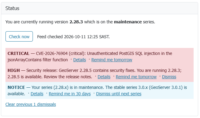

This module tells the administrator, in the GUI i.e. in their face, what applies to their running version:

Here’s a really quick test for you to run, using the pre-release JAR on an older version (2.28.3) which will produce warnings:
# 1. fetch the release artefact into a folder
mkdir -p ~/gs-libs
curl -sSL -o ~/gs-libs/gs-updates-checker.jar \
  https://github.com/petersmythe/geoserver/releases/download/updates-checker-test-2/gs-updates-checker-3.1.0-SNAPSHOT.jar
# 2. run GeoServer 2.28.3 with the folder mounted and the alpha feed
docker run -d --name gs-2283 -p 8080:8080 \
  -v ~/gs-libs:/opt/additional_libs:ro \
  --env UPDATES_CHECKER_FEED_URL=https://raw.githubusercontent.com/petersmythe/gs-updates-checker/alpha/versions.json \
  docker.osgeo.org/geoserver:2.28.3
#3a. login and view the Welcome home page
#3b. or check the REST call
curl -u admin:geoserver -X POST http://localhost:8080/geoserver/rest/updates-checker/check
