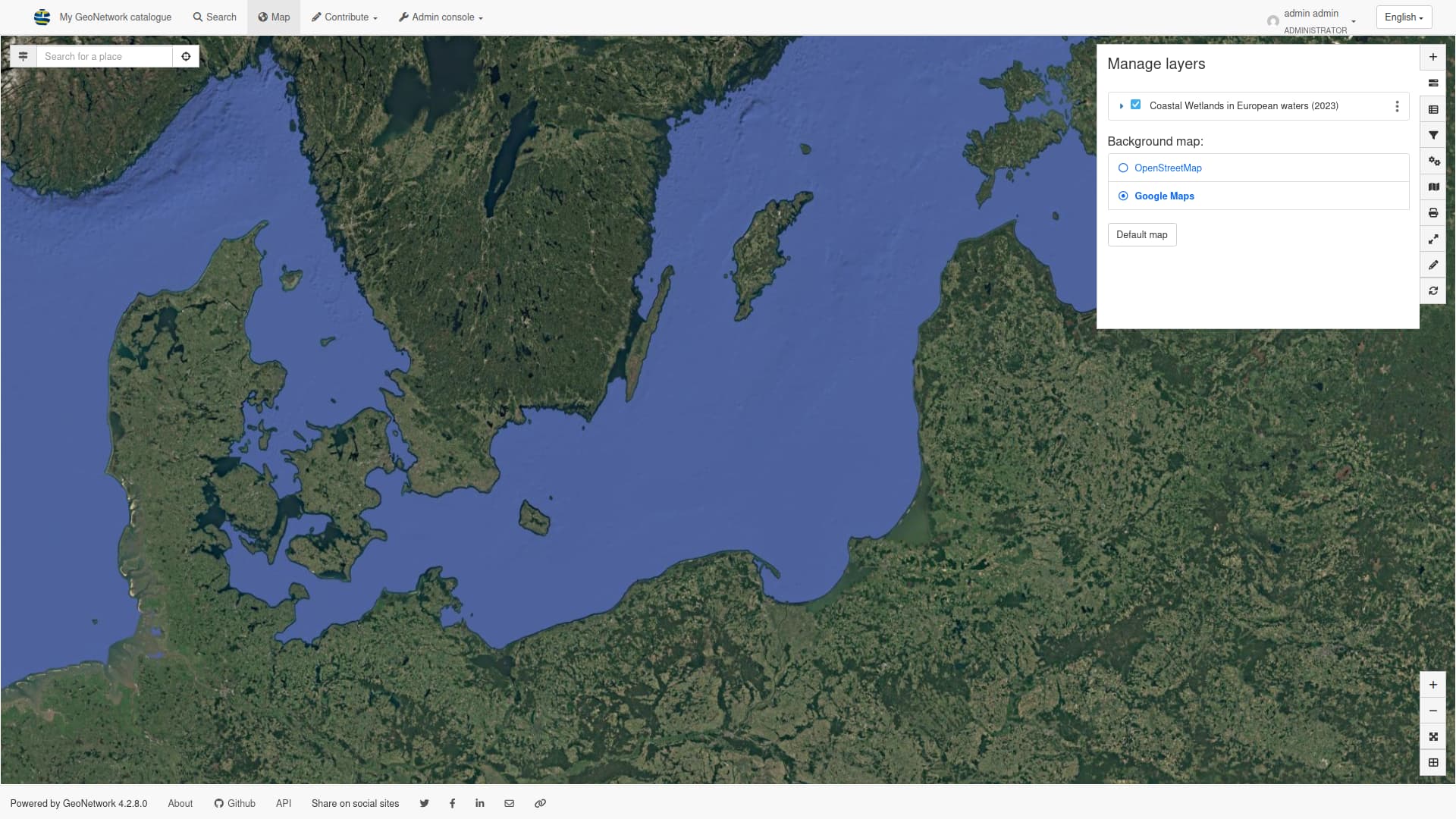

Is there something wrong with the initial context file, or is downloading this type of layer not implemented in GeoNetwork? The map context displays fine though, and the Google Maps layer is rendered correctly:
