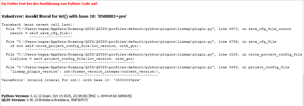

I am now experiencing the above error again in the current version lizmap.5.0.0-alpha.3+pre.zip from March 9, 2026. Can I fix it myself?
@meyerlor has open a pull request to fix it Fix version parsing crash with semver build metadata suffix by meyerlor · Pull Request #715 · 3liz/lizmap-plugin · GitHub
The fix is now available in https://packages.3liz.org/pub/plugins/lizmap/lizmap.5.0.0-alpha.3+pre.zip

But does the link already contain the new version?
The file is exactly the same size as yesterday’s and the error still occurs.
Sorry, the zip file was not generated yesterday. I have forced the CI and now the file contains the fix.
Thanks, now saving works without an error message.
