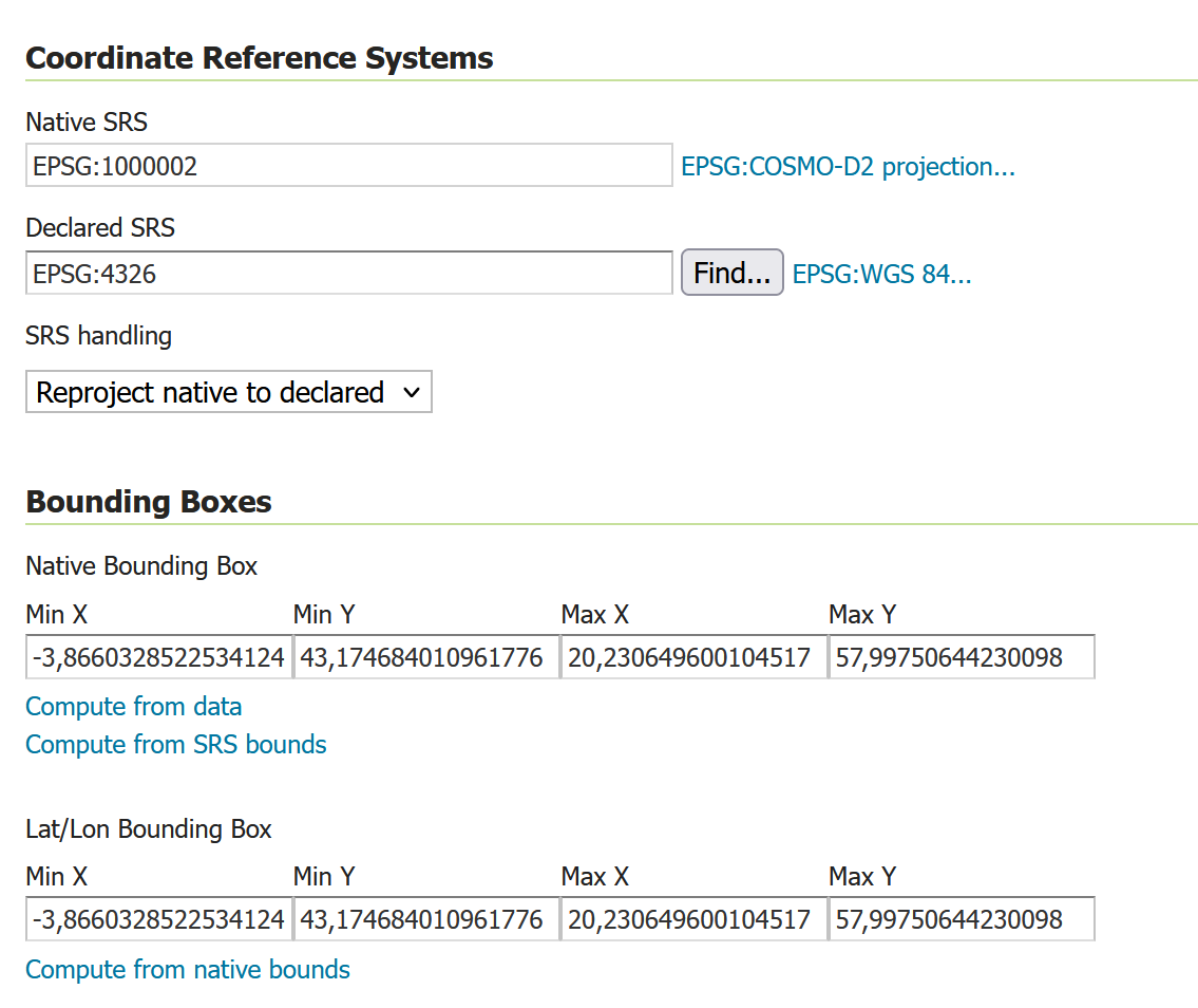

we have a problem using WCS with layers that have a native CRS different than the declared CRS.
We do e.g. have data defined on very particular meteorological CRS (which we have defined in the user_projections file). Now as we don’t want this to be the declared CRS, we have configured the layer as such:
  • native CRS: EPSG:100002 (defined by the data)
  • declared: EPSG:4326
  • projection handling: reproject native to declared
Now the problem is that for WCS requests on that data, the requests usually fail because of the spatial subsetting.

Hi @jratike80 ,
good question. It’s actually not so unusual after all, just the parameters are:
data/user_projections/epsg.properties:
# COSMO-D2 projection
1000002=PROJCS["COSMO-D2 projection",  \
  GEOGCS["COSMO-DE Coordinate System",  \
    DATUM["COSMO Sphere",  \
      SPHEROID["COSMO Sphere", 6371229.0, 0.0]],  \
    PRIMEM["Greenwich", 0.0, AUTHORITY["EPSG","8901"]],  \
    UNIT["degree", 0.017453292519943295],  \
    AXIS["Longitude", EAST],  \
    AXIS["Latitude", NORTH]],  \
  PROJECTION["Rotated_Pole"],  \
  PARAMETER["central_meridian", 10.0],  \
  PARAMETER["latitude_of_origin", 50.0],  \
  PARAMETER["scale_factor", 1.0],  \
  PARAMETER["false_easting", 0.0],  \
  PARAMETER["false_northing", 0.0],  \
  UNIT["m", 1.0],  \
  AXIS["x", EAST],  \
  AXIS["y", NORTH],  \
  AUTHORITY["EPSG","1000002"]]
This is the projection (Rotated_Pole) we use for the our local numerical weather models. And we defined some transformations at:
data/user_projections/epsg_operations.properties:
# COSMO-D2 -> EPSG:4326
4326,1000002=PARAM_MT["Rotated_Pole",  \
    PARAMETER["semi_major", 6371229.0],  \
    PARAMETER["semi_minor", 6371229.0],  \
    PARAMETER["false_northing", 0.0]]
This has been working nicely for WMS for years now. But now our users would like to access the data using WCS. They would typically runs their requests in EPSG:4326, because they are more familiar with the that CRS. But I guess the problem would be in any other sub-setting CRS.
Now it turns out that the granules are all in EPSG:1000002 (the native CRS) while WCS builds its spatial query based on EPSG:4326 (the declared CRS).
So basically the intersection filter applied to the features of the GranuleSource is comparing apples and oranges.
So it seems.
