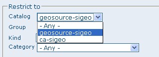

The point is that the import associated the name of the previous Geosource catalog with the metadata. And wether I delete these metadata or not,
this catalog name is still in my research list and maybe confusing.
See joined image :
geosource-sigeo is the catalog I'd like to remove from the list
ca-sigeo is our current catalog
Any idea to remove this unused catalog?

Any idea about the original question, how to remove an unused catalog
name in the search list?
This list is built from database and settings. To remove the older reference
to "geosource-sigeo" you have to check from both :
- your settings, on the administration page, to be sure your local name
(siteId) is "ca-sigeo".
- the content of the "Sources" table in your database.
