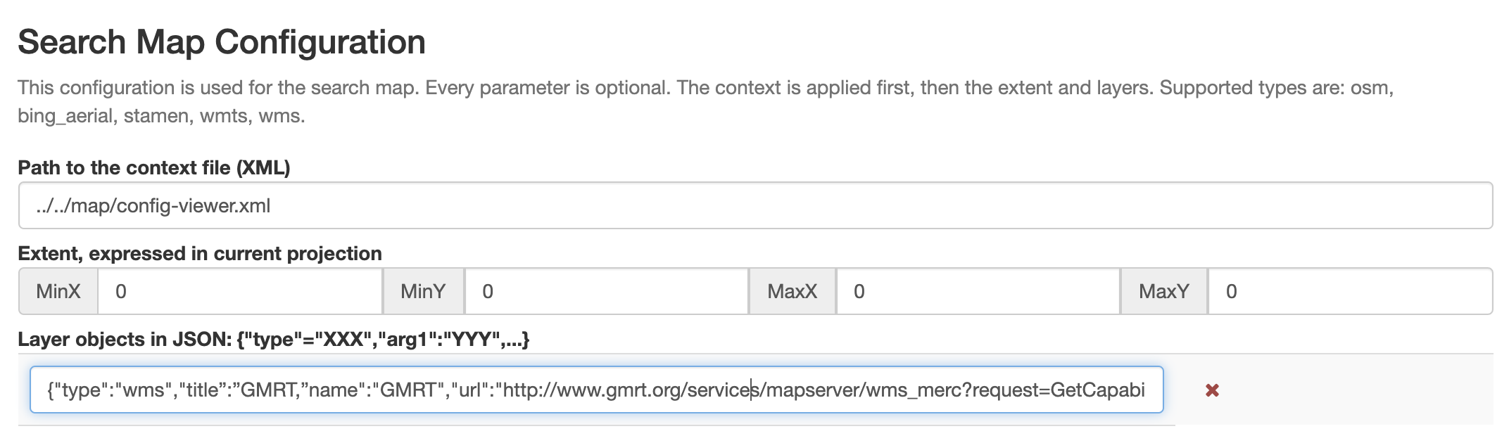

I've been trying to change the background layer (OSM) to another one in the
search map but I had no success. In the following image you can see where I
added another Wms service as a background layer, using the following string
*{"type":"wms","title”:”GMRT,”name":"GMRT","url":"http://www.gmrt.org/services/mapserver/wms_merc?request=GetCapabilities&service=WMS&version=1.3.0
<http://www.gmrt.org/services/mapserver/wms_merc?request=GetCapabilities&service=WMS&version=1.3.0&gt;&quot;,&quot;projectionList&quot;:\[&quot;EPSG:4326&quot;\]\}*
!image.png|2144x630
Is it the way to make it work? Do I have to do something else? I can't see
any change and still the OSM map appears.
Thank you very much for your help,
Xavi

the OWS context file is cached by default in the browser session storage.
Please try using an incognito window. If it loads the new layer then clear
the cache of the browser.

Thanks a lot Juan Luis, I finally solved my problem and with the incognito
window I could see it worked fine.
Regards,
Xavi
