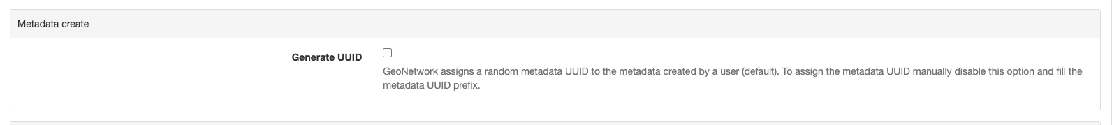

1. In the Admin Console -> Settings disable the Generate UUID option:
!image.png|1592x179

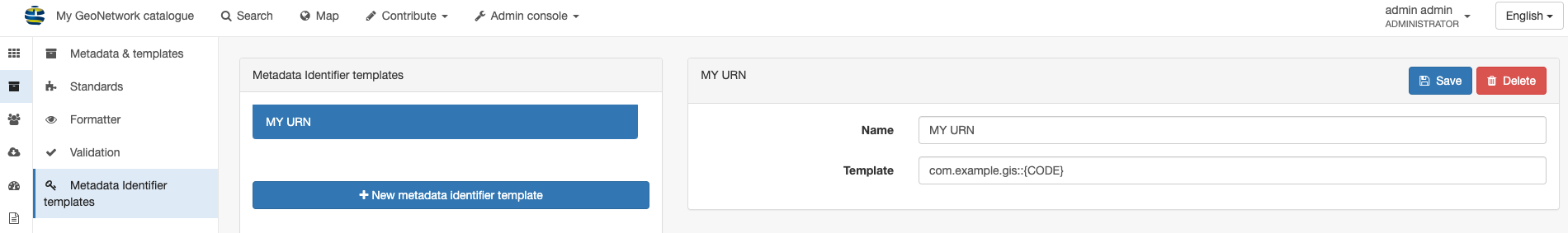

2. In Admin Console -> Metadata and Templates -> Metadata Identifier
templates create a new template:
!image.png|1900x283

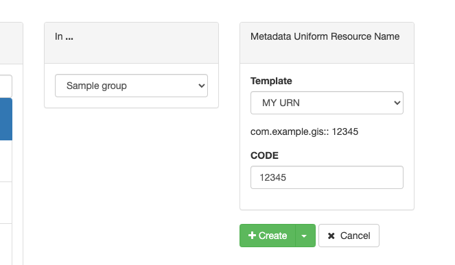

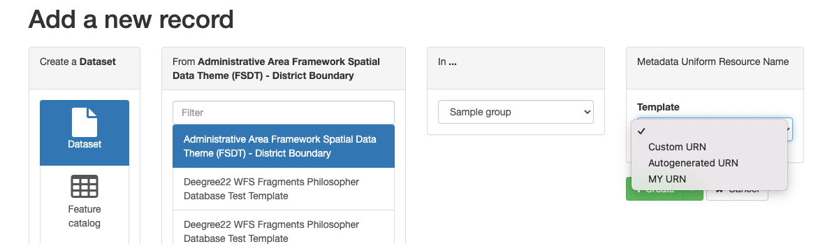

3. When creating a new metadata select the desired Metadata Uniform
Resource Name. Keep in mind that Autogenerated URN option is the regular
random UUID. Select your custom URN template:
!image.png|1201x349
!image.png|663x387
6. The URN is used as fileIdentifier and in the record URL:
