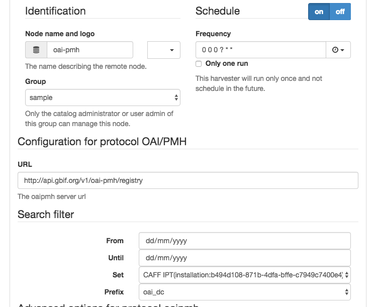

I'm trying to harvest using oai-pmh protocol with no results.
I'm using this url for the harvesting and it gives a result, but Geonetwork
isn't receiving anything.
<http://osgeo-org.1560.x6.nabble.com/file/n5295006/harvest.jpg&gt;
I always get java error in the log fle:
2016-11-08 14:06:24,075 WARN - Raised exception while getting metadata
file : java.lang.NullPointerException
2016-11-08 14:06:24,075 WARN - Check with your administrator the error.
2016-11-08 14:06:24,075 ERROR -

Hi
I've done a quick test using the same set as you are using with a 3.2.x
branch setup and get the 62 records harvested properly.
I see 62 records harvested. Which version are you using?

Hi
I am not certain about GN log verbose (can't remember how to increase
verbose of logs), but I think the geonetwork log contains the requests
done during harvest. It is very likely that you have a URL list of the
request made to the OAI, copy a few requests and see what the OAI
returns or does, maybe there is something misconfigured
I think NullPointerException happens because you are not getting any
content. Looking at your last email, have you configured GN to use:
set --> installation:b494d108-871b-4dfa-bffe-c7949c7400e4
metadataPrefix --> oai_dc
Also, after setting the URL on the GN do you see available sets ???
(manual list of sets)
http://api.gbif.org/v1/oai-pmh/registry?verb=ListSets
and see the metadata options
http://api.gbif.org/v1/oai-pmh/registry?verb=ListMetadataFormats

Thanks a millions Jose
It works now.
I was doing it in a wrong way. I putted the"set" and "prefix" in the URL
not in the "search Filter"

Thanks a millions
It works now.
You guys are great
