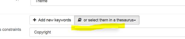

3.) When trying to add a thesaurus to an item in the catalogue, this
dropdown where I presume we should be able to find a list of thesauri, is
empty
