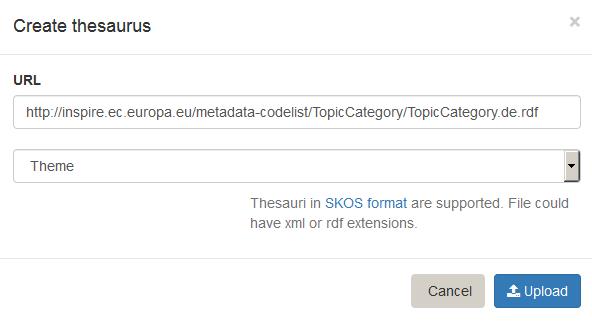

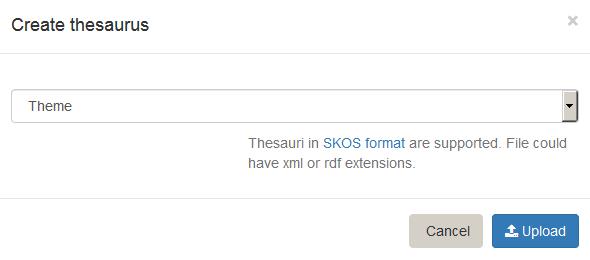

After login (role: administrator) und choosing the option "classification systems" in menu "admin console" I used the following "Add thesaurus" options:
a) from registry --> problem: I have no upload dialog or an alternative option to choose the file.

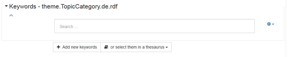

b) from URL --> Problem: the import is successful but I am not able to choose the values from the thesaurus in the editor.

Hi Steffen,
The only way it worked out for me was to download the rdf file and import it through the option "From local file".
Best regards,
Sibylle

Hi Steffen
The selection of keywords in the editor afaik depends on the language of
the metadata (gmd:language element if iso19139) and not totally sure if
also depends on the UI language of the editor.
If you're using metadata in german language, check that the thesaurus
values are in german and the metadata language is also set to german.
Regards,
Jose García

Dear community, dear Jose.
Thanks for the hint but it doesn’t work for me. Any alternative solutions?
