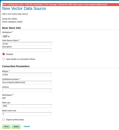

Hi,
I’m migrating from geoserver 2.25.2 to 2.27.2 and using the docker image also.
I follow the documentation, that says the context.xml now is inside the tomcat server.xml, but somehow the geoserver cannot find it.
I’m using the oracle plugin, with JNDI connection.

error:

I am not sure how that works, for the oracle connection to be defined by tomcat, tomcat needs to have the JDBC driver.
Do the tomcat logs say anything on startup trying to create jdbc/oracle ?

My problem was that i configured under “geo-configs”, a server.xml and a server-https.xml.
I’m not sure, but probably i need to choose the one that i want and deploy it.

Now it works with only one “server.xml” file. :blush:
