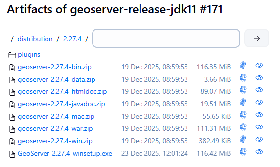

Gabe, same as last month, I do not see the Windows Setup executable in the artifacts:
Compare to 2.27.4, where the winsetup.exe appeared days later:
Perhaps the same problem is occurring @jive ? Ref: You're invited to talk on Matrix

Oh I see, the release guide says “if the .exe artifacts do not appear, ask GeoCat to investigate the Azure worker.” so I’m asking @jive

The windows installer was fixed by Juan (the dockerfile was using windows server 2019 which was no longer available in azure.
See Artifacts of geoserver-release-jdk11 #171 : /distribution/2.27.4 - Jenkins for GeoServer-2.27.4-winsetup.exe.
