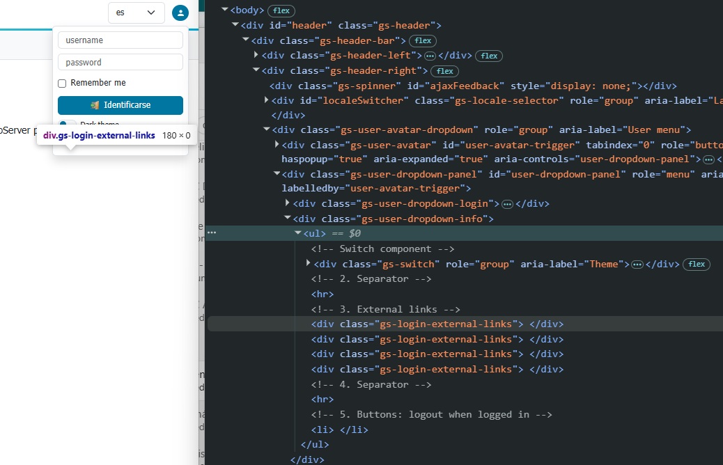

Turns out the filter was already working but a wrong bean registration required a GeoServer restart in order to show the buttons.
Anyway, I took the occasion to fix this and some more other issues and improvements.
PR here fix(oidc): expose dynamic login buttons via ExtensionProvider and OIDC multi button login by afabiani · Pull Request #9499 · geoserver/geoserver · GitHub

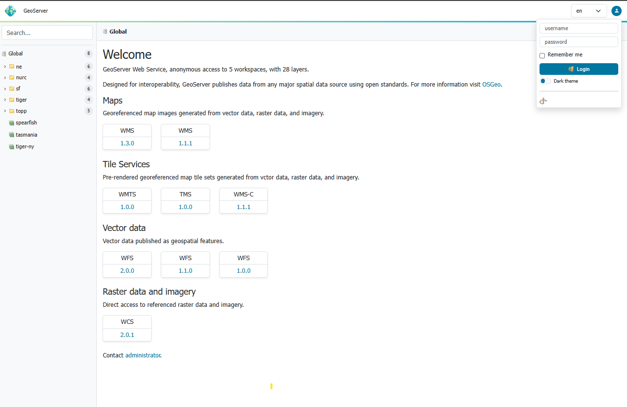

PR merged, build the plugin again and try to reconfigure it. Notice that the redirect_uri will be different.
Let me know.
Afternoon.
We have tried the last version (May 14) of the 3.0.0-SNAPSHOT OIDC plugin, and is already working.
It logs in correctly against our Keycloak, so it works perfectly.
Thank you, Alessio!
