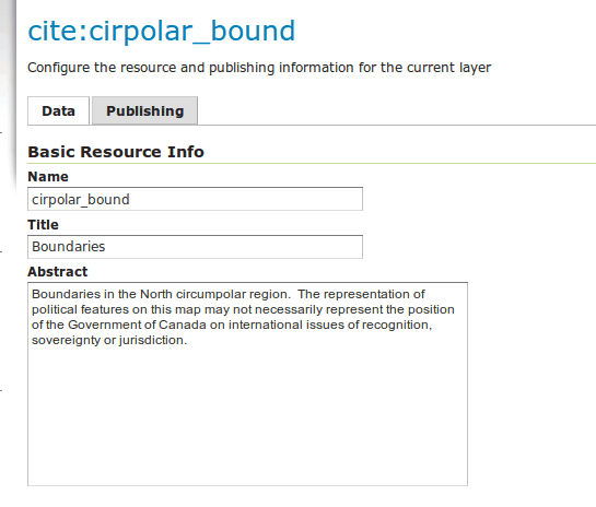

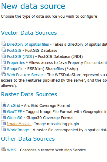

Once patched the GUI allows to create a new "WMS store" by
providing a capabilities link. After that we get to the usual
layer listing, and then to the usual layer configuration
page.
The layer config page metadata are filled using the values
found in the cascaded WMS capabilities document, including
bounds, srs, descriptions, keywords and whatnot.
The only visible difference compared to a normal layer config
page is that you don't have a style chooser, since cascading
works, at this point, by simply using the default style.

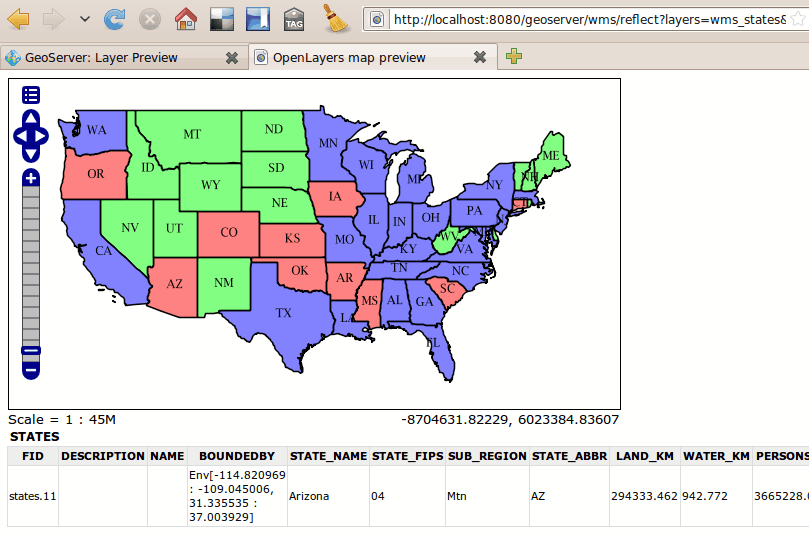

The preview shows the cascaded layers with their own icon
(thanks Rollie for being prevident and preparing WMS layer
icons as well), and you can then follow and browse the
cascaded maps as if they were local.

I've also implemented GetFeatureInfo cascading for the
case in which the remote server supports GML2 output
This has been tested against GS only, could not find
a MapServer instance that actually does GML output,
often it's listed in the caps but results to the request are
consistently empty.
GetFeatureInfo cascading works also in the reprojected
case.
page.
consistently empty.
case.
