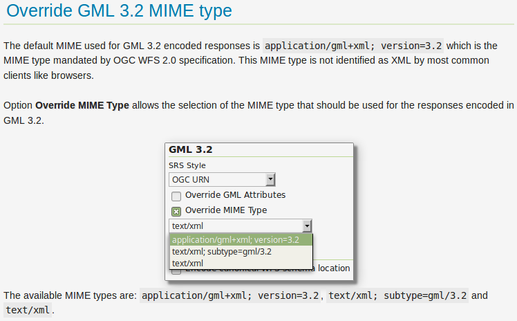

I just updated the pull request [1] with the option to override the MIME type:
Basically I add a flag that activates the MIME type overriding and drop down choice that allow us to select which MIME type we want to use.
Regards,
Nuno Oliveira
