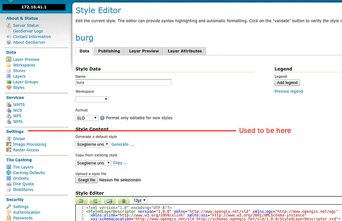

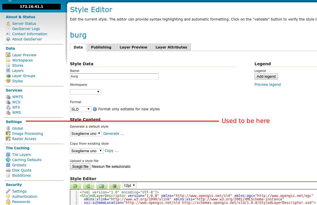

The preview tab seems to be borderline useless, at least I don’t see a way to have the edits update the preview. E.g. choose “capitals”, edit the style to use a square instead of a circle, switch to the preview page, the edit did not take, press “submit” and get thrown back into the layer list page. Being able to edit and preview without interruptions is the major selling point of the CSS editor. I’d recommend to have an “apply” button of sorts, that would save without exiting, or keep submit, but make it so that we don’t exit the editor, and replace “cancel” with an explicit “exit”, or something like that.
The publishing tab with the association works, but it may be a bit of a shock for users in that it saves the associations immediately as one clicks on the checkboxes. Saving at the end might be hard to implemented, but we have an inconsistency there, in that the style need to have “submit” pressed, but not the associations.
Edits are getting lost while switching tabs:
  • Open burg
  • Set the style workspace to “topp”
  • Go to publishing (all layers are available for association, not just the ones in topp)
  • Go back to data, the workspace dropdown is no empty
  • The same goes for all “legend” editors (online resource, width, height, format)
  • The same happens when switching to any other tab
Create a new style, do not edit anything, go directly to the assocations, associate the current un.saved as
the default with tasmania_roads. Apparenlty nothing happened, and no errors are there.
Exit the editor without saving, preview tasmania_roads, boom:

  • Clicking on the “reformat” button in the SLD editor brings the page up. Not a regression actually, the same happens on 2.9.x, it’s just that the style editor used to fit in the main screen of my PC with the old layout, and I have to scroll down to edit now instead (. The new layout pushes the editor down a lot, the following image shows by how much:
    Without requesting major reworks, a modest proposals: remove the title “burg” at the top saving thus significant space?​
  • The title page states “Click on the “validate” button to verify the style is a valid SLD document.”, however the style is not necessarily a SLD anymore. This is not a regression, it was there before, just noticed it now because I’m looking at the page more carefully than usual.
That’s all I’ve found so far, doing only interactive testing.
I would recommend against cutting a m0 with all these issues.
