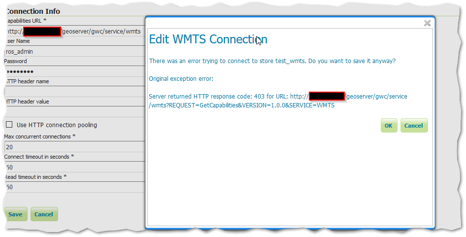

Hi Andrea,
Ian, I think that WMS/WMTS/WFS cascading never supported anything besides basic and maybe digest authentication.
​I can report that I did WMS Cascading​
​with Authkey successfully and it works.
So I wanted to Cascade WMTS in similar way so I can reuse tiles from the source Geoserver and then it wasn’t working wiht the same Authkey.
In the same line, WMTS Cascading with Basic Authentication does not work either
