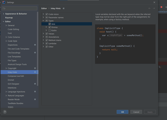

Thank you for starting the discussion. About your first doubt, Intellij IDEA has a feature to give hints about the implicit types like this.
To enable this, you just need to enable Java type hints.

Hi Can,
good to know. Mind one detail, the project does not mandate a particular IDE, everyone is free
to use whatever they prefer, IntelliJ, Eclipse, VS Code, Netbeans or even just VIM (not as
bare bones as one might think, with the right plugins).
