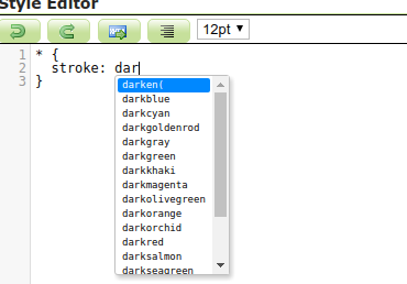

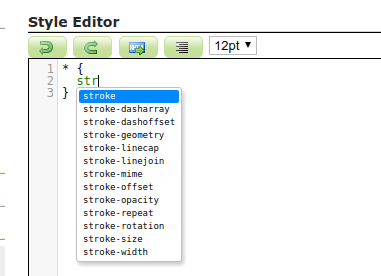

So I looked into what code mirror has to offer, and adding support for our custom
variant of CSS is not hard and works reasonably well (for modest ambitions), .e.g:
Let me qualify “modest” ambitions:
- There is no CQL autocomplete support
- The list of values for a given property is not context sensitive, it just gives you all possible values for all possible propeties
- The few function like values (url, symbol, color-map-entry) just complete as “keyword(” and you have to add the rest manually
Of course it can be improved with some time and JS skills, but I believe even this small contribution is a big improvement compared to no completion at all.

I checked how this plays with other languages, and it seems it’s not interfering, you just get no completion on CTRL-SPACE.
