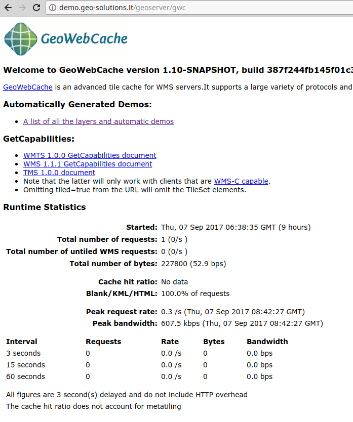

I’m working on a fresh deploy of the master branch and following the seed/truncate link
from the “tile layers” page results in a JSON file instead of the usual HTML page, e.g.:
http://cloudsdi.geo-solutions.it/geoserver/gwc/rest/seed/test:SENTINEL1_MOSAIC
returns (if you have admin access):
  • long-array-array:
Also, going from the “Caching Defaults” page and following the link “Go to the embedded GeoWebCache home page”
which points to:
results in a 404.
To make sure it was not something local to that server I’ve downloaded a nightly build, Sept 7th, and
with the vanilla configuration the issue is exactly the same.
I’m guessing this is a result of the GWC REST API migration but… we really need that UI, removing it is
a major regression. This is a release blocker…

Andrea,
The UI hasn’t been removed, but is in a new location. “/seed/ui_form/{layer}” I think it would be best at some point to move the UI out of the rest module for GWC.
Thanks

Hi David,
that’s known as a backwards incompatible change and it will cause discomfort on the user base.
On Gitter we discused and David assured me the XML/JSON urls are still working, it’s the HTML representation only
that has been moved… which means seed automation should work seamlessly across the upgrade (which is imho the most important point).
Still, it would be best to avoid moving the “UI” (which is really just a HTML representation of the same resources).
If moving it is 100% unavoidable you’ll still have to fix the links from the GeoServer UI to the GWC one, and fix all the
references from GeoServer and GWC documentation.
By the way, more feedback:
I’m getting a 404 for it (as reported in my first mail)
Regards
