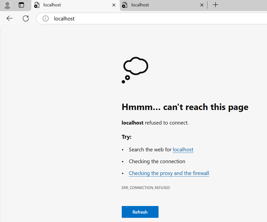

We use GeoServer deployed in Tomcat for our applications that send only WMS and WFS requests to GeoServer.
Periodically we have issues due to high RAM usage (please see screenshot).
When I press the Free Memory button, only a small part of the memory is freed (max ~1 GB out of 4), and then in quite a short time the memory becomes full again.
In the worst case, the Tomcat service keeps running and consumes almost all of the memory, but the Tomcat Manager itself and GeoServer stop responding.
Can you please share your experience on how you deal with this? Is it better to set 50% or 75% of RAM in Max Memory Pool in the Tomcat configuration? We have servers with 4GB and 8GB of RAM.
