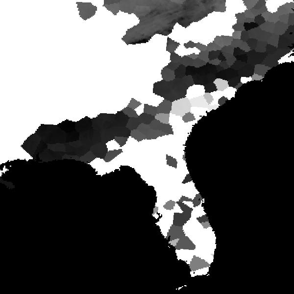

they both work fine for me as single-file GRIB stores (WMS output attached).
Is the directory containing the GRIB files writeable? GeoServer (and the NetCDF-Java library it uses to read GRIB files) will need to write a bunch of metadata (hidden index files) when reading NetCDF/GRIB:
http://docs.geoserver.org/latest/en/user/extensions/netcdf/netcdf.html#netcdf-files-in-read-only-directories
I do not know if this setting is honoured by NetCDF-Java for its GRIB-specific index files.
