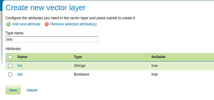

Hi,
I was thinking about the same, but if user can do something with the user interface then why not with REST? Both are secured only by the username/password. However, I do not know if it is possible to drop database tables from the UI. I have seen some user requests about cascading deletes so that deleting a layer would also delete the data. I think that is not a good idea.

Table creation is already allowed both by the importer (which also imports the data), and by the GUI/REST API for table creation
(WFS-T should then be used for data import):
Having a delete would make things symmetric, and I agree that cascade should be explicitly added for that
to happen.
That said, I also hear the voice of those claiming “geoserver should not be used to manage data”.
For that, we should have a simple warning in the production section: “GeoServer offers ability to create
and drop tables through UI and REST API, if this is not your intent, please lock down the database
grants for the account used by GeoServer”… which is generally speaking also good IT hygiene in general.
(don’t give accounts more rights than necessary).
