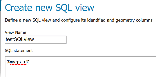

HI Olyster,
Really appreciated and yes, this could be the best solution for parameter-zing SQL views. I will do more tests on it. In our case, almost it will be like this
At lease, I have to redesign our table with standard names like, ID, NAME, POPULATION then I may need to have parameters not only in sql where clause, it may like as “select t1.ID, t1.geometryField, t2.NAME, t2. POPULATION from
table t1 inner join %tablename% t2 on t1.id = t2.id where %userinputclumnvalues%”.
I will give a try to see how works.

This would allow fully open SQL injection attacks (so you’ll have to be in control of whatever is adding view params in the requests), plus,
it’s unadvisable to have a sql view whose output columns can change, GeoServer won’t work well with it (at the very least, the
WFS portion of GeoServer).
