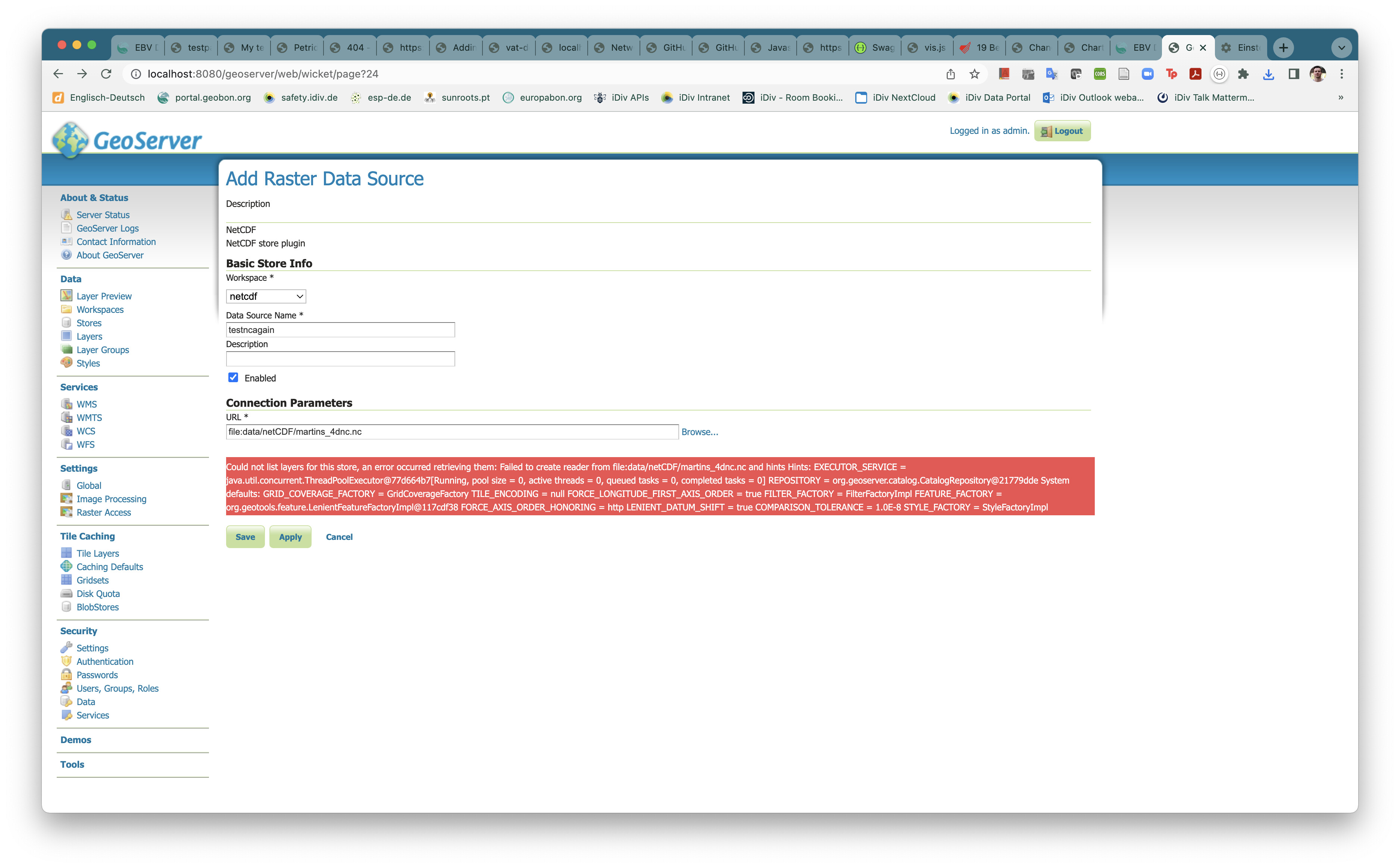

We would like to create web services from netCDFs files with the geoserver netcdf plugin, unfortunately the plugin cannot read our netCDFs structure.
To get an idea of the structure of the netCDFs you can check this page: https://git.idiv.de/lq39quba/ebv_data_standard
Two datasets that we propose for ‘taking a look’ are the following:
We are using GeoServer 2.20.1 with the netCDF plugin (geoserver-2.20.1-netcdf-plugin.zip) on a Tomcat 9 locally on a Mac (localhost:8080).
We have followed the tutorial: https://geoserver.geo-solutions.it/multidim/multidim/netcdf/netcdf_config.html#netcdf
We are getting always the error: “Could not list layers for this store, an error occurred retrieving them: Failed to create reader from file” (please see screenshot attached). It seems geoserver has problems to handle the 4th dimension. Complete log file here: geoserver.log

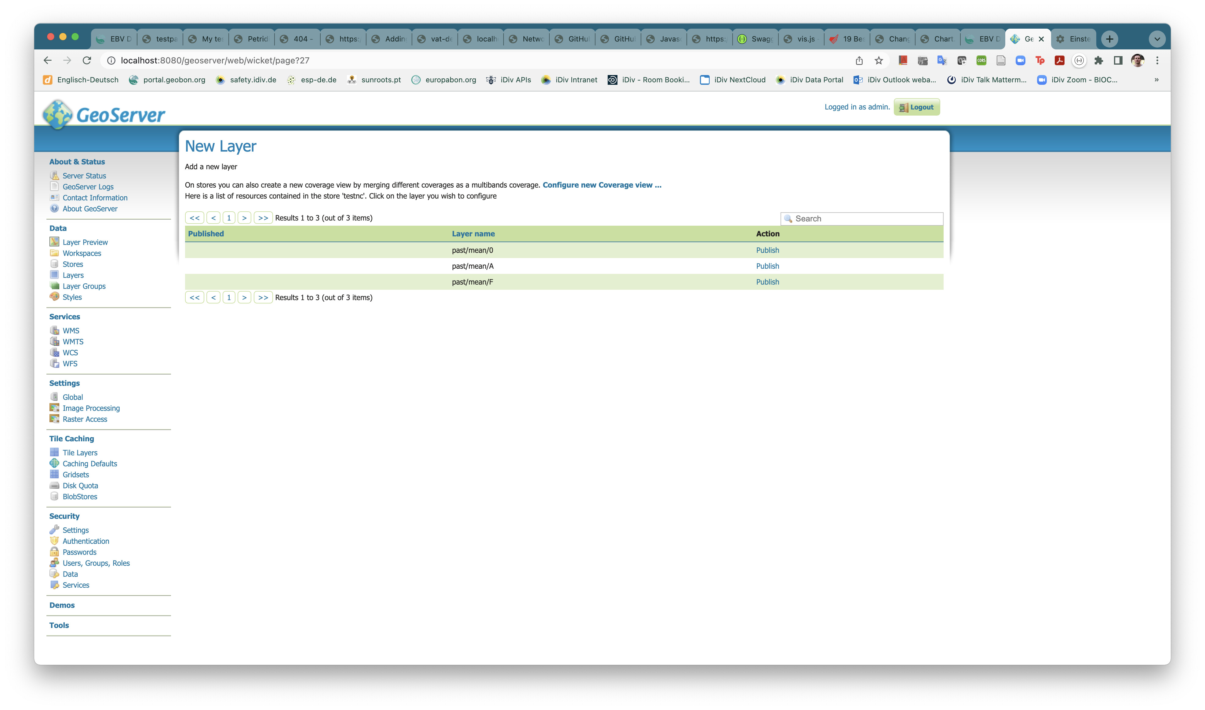

We have tried the same with a netCDF structure in 3d and it works like a charm - geoserver could list the layers (see screenshot attached).

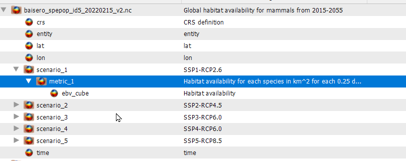

According to the documentation, GeoServer should be able to open files conforming to the COARDS convention…
checking the files with PanoplyJ I see a grouping/netsting construct I haven’t seen before, which does not seem to appear
in COARDS either:
It might be possible to have GeoServer open these files, but I guess that would need some code
modifications in the NetCDF driver.

Unfortunately we haven’t found a solution yet why geoserver has problems to create webservices from a netCDF data file with a 4d structure (lat, lon, time, entity).
Still we can’t add the netCDF files as “netcdf store” in the geoserver to list the layers.
@Andrea
The nesting/grouping doesn’t seem to be the problem, since geoserver can create webservices given a 3dimensional netCDF structure (lat, lon, time) with the same nesting.

Error message:
Could not list layers for this store, an error occurred retrieving them: Failed to create reader from file:data/netCDF/martins_v1.nc and hints Hints: REPOSITORY = org.geoserver.catalog.CatalogRepository@…11690… EXECUTOR_SERVICE = [java.util.concurrent.ThreadPoolExecutor@…11691…Running, pool size = 0, active threads = 0, queued tasks = 0, completed tasks = 0] System defaults: COMPARISON_TOLERANCE = 1.0E-8 FILTER_FACTORY = FilterFactoryImpl STYLE_FACTORY = StyleFactoryImpl FEATURE_FACTORY = org.geotools.feature.LenientFeatureFactoryImpl@…11692… GRID_COVERAGE_FACTORY = GridCoverageFactory TILE_ENCODING = null FORCE_LONGITUDE_FIRST_AXIS_ORDER = true FORCE_AXIS_ORDER_HONORING = http LENIENT_DATUM_SHIFT = true
