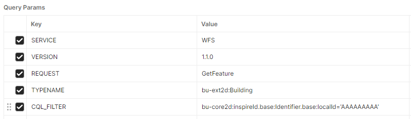

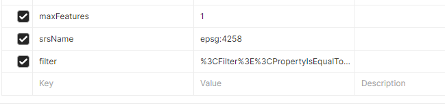

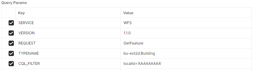

Find attached some of the tests I’ve done:

Unfortunately, I don’t have access to Geoserver and that’s the reason why I can’t give more information about the server.
Is there any other workaround to get the response I need from the WFS request? Do you think I’m doing anything wrong in the CQL_FILTER?
Any help will be appreciated.
