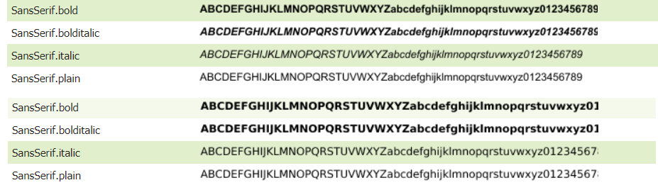

Hi Andrea,
Both environments have Oracle JRE installed. I’ve just compared the font previews in the Geoserver web interface and they do differThe first group is from Windows and the second one is from Linux
So most likely you are right thinking that JVM is using system fonts, rather than the default Java fonts.
