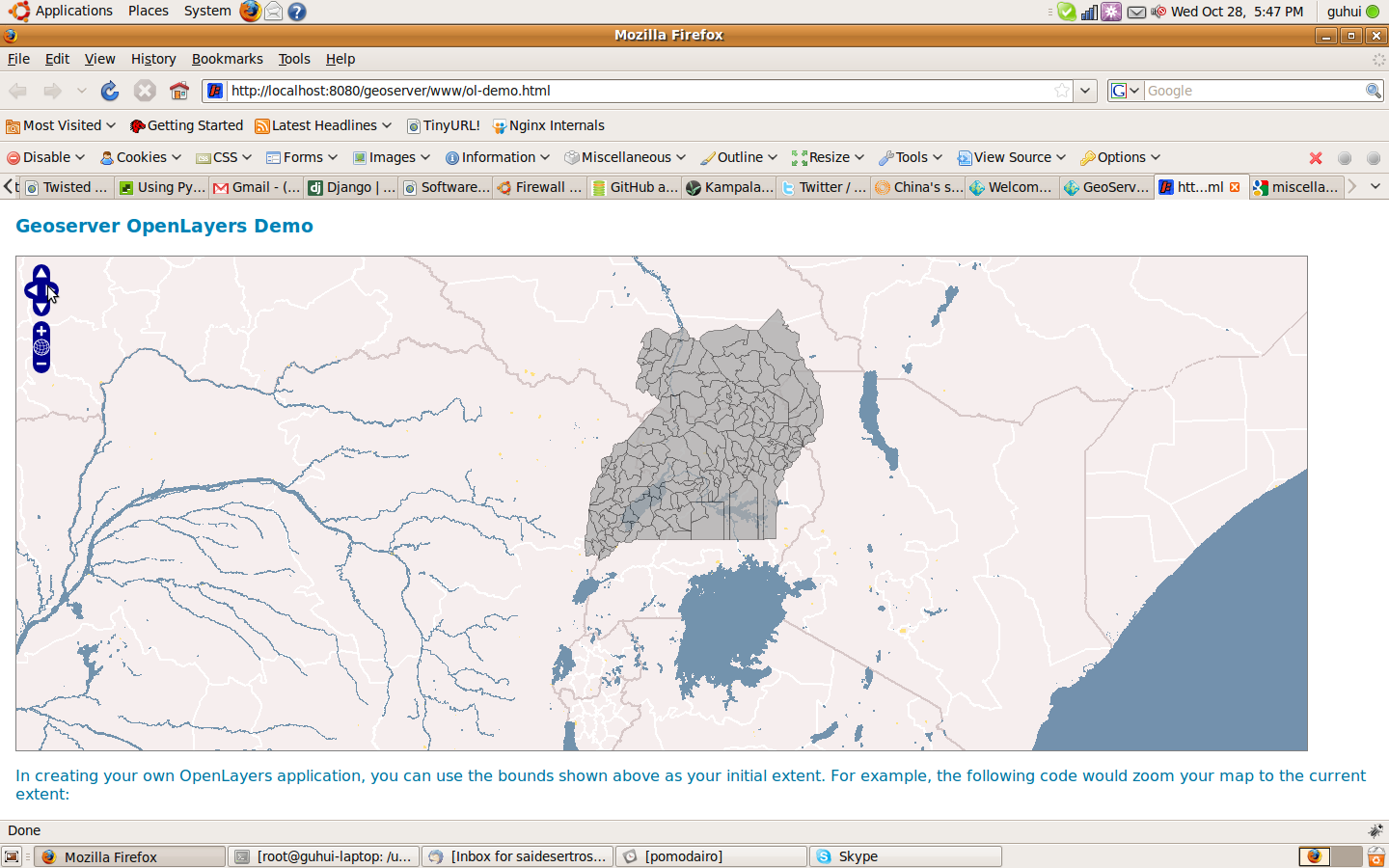

We am working for a mapping project for UNICEF and we are planning to use Geoserver for displaying info on maps using shape files. The idea is same as the Google map overlay example which comes with Geoserver.
I have the shape files of Uganda. And I am using them to show the administrative districts on top of Google maps. The overlay seems to be showing up on the map but it seems to be off the mark.
I have attached a screen shot of the map which uses Metacarta as the base map layer.
The screen shot of the map which uses Metacarta as the base map layer and geoserver showing the shape file (misaligned) is attached here. http://miscellaneous-downloads.googlecode.com/files/uganda.png

The misalignment you're getting is huge. The most likely cause is that
your data is actually in a SRS other than EPSG:32636. You should double
check your data and the source of it and figure out what the actual native projection is.
Hi Sai,
Most likely it is just an issue with projections. In order to overlay on to a google maps you need to have your data reprojected properly into the spherical mercator projection. There is an example in the openlayers docs for doing this:
http://dev.openlayers.org/releases/OpenLayers-2.8/examples/wfs-reprojection.html
My guess is that the OL WFS layer does not have the projection specified.
You also might get some better help on the openalyers forum.

Thanks for the reply. You are right. The problem was with the project. The maps we got from UN OCHA weren't having projections data properly in prj files. We got a different set of shape files from GADM and it seems to be working fine for us.
