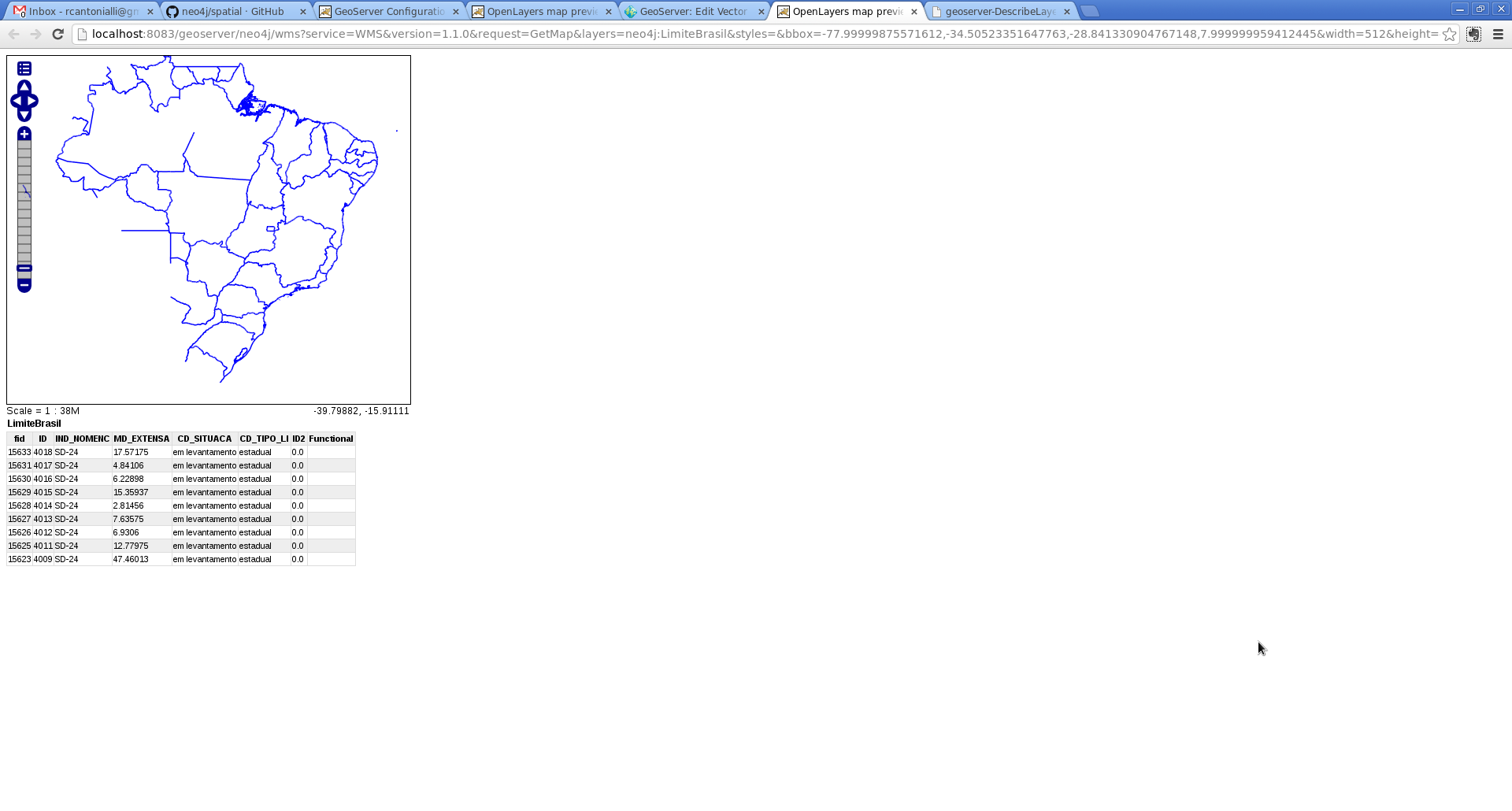

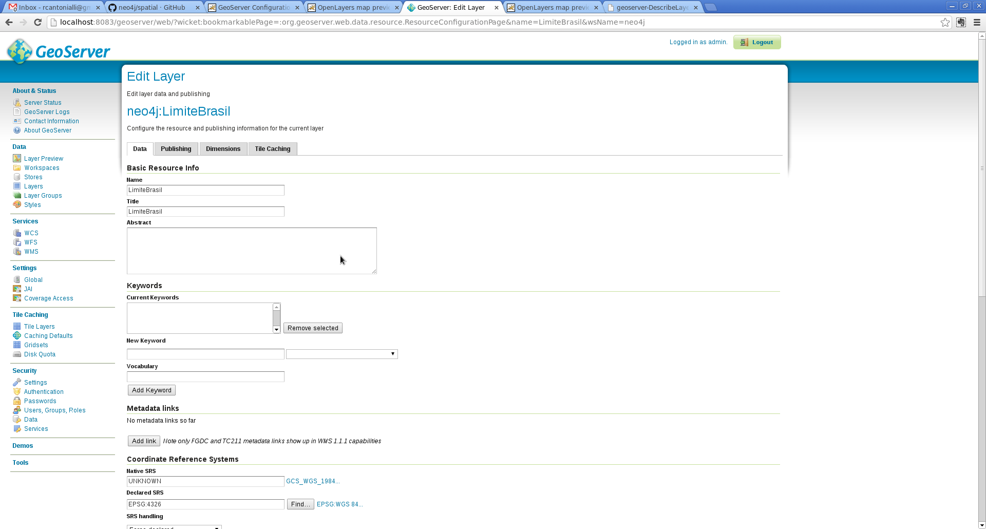

Hello again!!
I just figured it out!!! Googling about the last error *"Caused by: java.lang.NoSuchMethodError: org.apache.xerces.impl.xs.XMLSchemaLoader.loadGrammar([Lorg/apache/xerces/xni/parser/*XMLInputSource;)" I’ve found this post and looked again in geoserver/WEB-INF/lib… there were 2 xerces jar files. One in version 2.7.1 (geoserver) and another 2.4.0 (neo4j).
I removed the xercesImpl-2.4.0.jar from lib and restarted geoserver. Now I can see Neo4j as a Vector Data Source.
Well, I should have searched this before, but now, there’s a hint in both lists.
I didn’t make a test yet… hope it works fine!

It works!!
The attached images show the map! There’s a map and the result of GetFeatureInfo!
Although I had some errors while importing the shapefile, the layer was loaded into Neo4j, and it was loaded also in Geoserver.
To make it works, I had to compare some lib versions between geoserver and neo4j-spatial. Most libs used by Geoserver are newer than neo4j-spatial, including geotools.
Some notes:
  • The shapefile was generated and exported here by the team with I work. I need to make some tests with other shapefiles (like the ones that ships with geoserver) to check the error during import.
  • From the neo4j-spatial zip file for version 1.9, I’ve copied only some jars to geoserver lib (basically, the different ones). I have a list showing the different libraries and which one I copied. It will be included in my docs.
  • One problem I noticed was that while showing the map (geoserver up), I wasn’t able to start neo4j server. It can’t create the lock file. I need to run some tests like starting neo4j server first, and also access neo4j from Java (including WPS processes).
As soon as I run new tests and have a clue about neo4j-server start, I’ll send some news.

It works!!
Some notes:
