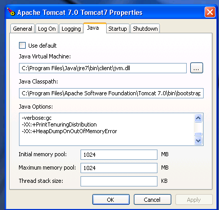

Hi Vikram,
I’m using tomcat 7 for Geoserver 2.4.0 in Windows XP platform. Check my JVM configuration below.It may help u.
1.Right click on tomcat service icon and goto configure
2.Update below values in ‘Java’ as shown in this screenshot.
Java Virtual Machine:
C:\Program Files\Java\jre7\bin\client\jvm.dll
Java Classpath:
C:\Program Files\Apache Software Foundation\Tomcat 7.0\bin\bootstrap.jar;C:\Program Files\Apache Software Foundation\Tomcat 7.0\bin\tomcat-juli.jar
Java Options:
-Dcatalina.home=C:\Program Files\Apache Software Foundation\Tomcat 7.0
-Dcatalina.base=C:\Program Files\Apache Software Foundation\Tomcat 7.0
-Djava.endorsed.dirs=C:\Program Files\Apache Software Foundation\Tomcat 7.0\endorsed
-Djava.io.tmpdir=C:\temp
-Djava.util.logging.manager=org.apache.juli.ClassLoaderLogManager
-Djava.util.logging.config.file=C:\Program Files\Apache Software Foundation\Tomcat 7.0\conf\logging.properties
-XX:NewSize=256m
-XX:MaxNewSize=256m
-Dsun.rmi.dgc.client.gcInterval=600000
-Dsun.rmi.dgc.server.gcInterval=600000
-XX:+UseParallelGC
-XX:PermSize=256m
-XX:MaxPermSize=256m
-verbose:gc
-XX:+PrintTenuringDistribution
-XX:+HeapDumpOnOutOfMemoryError
Memory values should be set as per your RAM. Refer page number 285 in GeoServer Beginner’s Guide [eBook].pdf

How to configure JVM settings..I am using tomcat. I don’t know how to apply the settings which is mentioned in the above doc..
Take also a look here:
http://geoserver.geo-solutions.it/edu/en/adv_gsconfig/gsproduction.html
http://boundlessgeo.com/whitepaper/geoserver-production-2/
