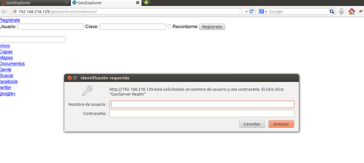

I’m trying to open my application but it gives me error with firefox, not so with google chrome and IE.
I try this query :
http://mydomain/geoserver/wms?service=WMS&request=GetCapabilities
in firefox asks me username and password (open window “geoserver realm”) , but in chrome and EI work well!
My version of chrome Versión 33.0.1750.117
my version of firefox 27.0.1
SO: Ubuntu 12.04 LTS
Thanks in advanced
Pablo

Hi Chris
Sorry, “open my application” just trying say that when I load my application fails in firefox , whereas if I do it in chrome or IE it does not. I’m using my GeoExplorer application and it uses basic authentication.
I delete Anonymous authentication from Authentication Filters because I do not want a user without authentication to access the preview layer that provides the adminitrative interface geoserver.
Attached my config.xml.
Thanks
Pablo
config.xml (2.28 KB)

Hi Pablo
In your config.xml I see the following filter chain responsible for OGC requests:
basic
anonymous
The anonymous filter is still there. Did you delete the filter ?. Deleting a filter which is still listed on a filter chain is not possible except you modified the configuration directly on the file system.
Btw, you can remove anonymous manually and restart GeoServer, but you should make a backup of the original file.
Cheers
Christian

Thanks Cris!
I resolved my problem, I did as you indicated.
I would like to return to the previous topic:
My WEBGIS application in chrome and IE works fine, but not Firefiox. In firefox asks me username and password but when I enter that data returns me the blank page (see image attached)
Please I need your help.
Thanks in advanded!!!
Pablo

Hi Pablo
I am not sure that I understand your problem.
Do you rely on the browser handling the basic authentication protocol or is the logic in your application ?.
Do you get popup login window only on Firefox ?.
Cheers
Christian

Hi Cris
Yes! just gives me the popup login window in firefox! but when I enter data (username and password), the application I get the blank window (attached before mail).
I’m using basic authentication through GeoExplorer and geoserver.
Using: geoserver 2.5.2
client: geoexplorer
Thanks !!

Hi Pablo
I assume you log in as described here
http://suite.opengeo.org/4.1/geoexplorer/using/login.html
If I got it right, GeoExplorer challenges you for the credentials and authenticates you to GeoServer (Basic authentication).
Obviously, GeoExplorer has a problem with Firefox. Use a tool like HttpFox where you can inspect the HTTP header attributes.
In the request, check for
Authorization: Basic …
I think this header attribute is missing in Firefox, bot not in IE and Chrome.
Cheers
Christian.

Hi Cris
