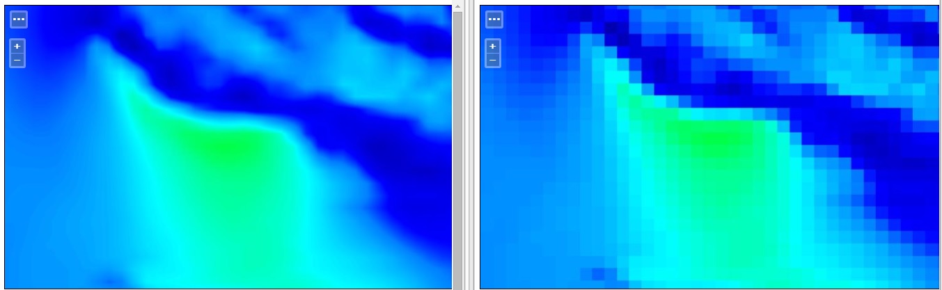

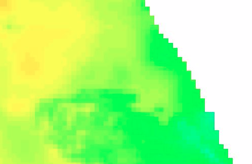

I’m working on a project that uses grib data, so have been using the
community grib extension.
I’ve not been able to successfully use antialiasing properly on any of my
example grib files in wms requests. All I can seem to get is pixelated
output.
I’ve tried all the different settings for antialiasing in the WMS settings.
Antialiasing? You mean interpolation right?
Antialiasing is only for vector data, what controls how smooth the output
is, it's interpolation.
It seems your data is interpolated "nearest neighbor", you might want to
try out bilinear or bicubic?
Which version of GeoServer are you using btw?
