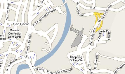

I am working with a Shapefile (EPSG:4326) that when opened on Google Earth fits like a charm on the correct coordinates.
But when I overlay it on Google Maps using GeoServer it doens’t FIT. 5 - 6 meters away from the target!
Anyone can tell me how can i Fix it?

Hello Arne, Thanks for the fast answer…
I changed the EPSG , as you recommended:
var wms = new OpenLayers.Layer.WMS(
“Univ”,
“http://localhost:8080/geoserver/wms?”,
layers: ‘tiger-ny’,
styles: ‘’,
srs: ‘EPSG:900913’,
format: ‘image/png’,
tiled: ‘true’,
tilesOrigin : “143.60260815000004,-43.851764249999995”,
transparent: true
‘opacity’: 0.75, ‘isBaseLayer’: false, ‘wrapDateLine’: true
But it stills come away from the target, as you can see in attach.
Do I need to reproject it? If yes, what is the best software for that?

That is not sufficient, for example the tilesOrigin will create problems. You can try setting it to -180.0,-90.0, but there could be other problems as well.
I repeat my suggestion to look at the source of the URL I gave you. My experience is that it's much easier to tweak a working copy than to fix one with broken tile alignment.
-Arne

Wooo Now worked like a charm! :smiley:
It is a bit out of site, but i think that could be georeferencing error.
Many Thanks.
