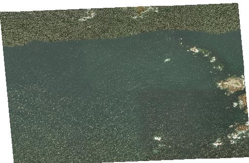

Hi I am currently running GeoServer 2.1.1 and have run in to a problem with creating an image mosaic and the appearance of gaps between the images. My creation process is thus; Source raster is 1km square imagery tiles in jpg with accompnaying .jgw files. I convert these to GeoTIFF using gdal_translate, and create index file using gdaltindex. When connected to Geoserver and drawn up you can see white gaps between the images which reduce in size as I zoom in, until they disappear at the highest zoom level. I have never experienced this problem with the numerous other raster datasets I have been using. Does anyone have any advice? Cheers

AndyC wrote:
Hi
files.
using gdaltindex.
highest zoom level.
Cheers
http://osgeo-org.1803224.n2.nabble.com/file/n6657350/image1.jpg
http://osgeo-org.1803224.n2.nabble.com/file/n6657350/image2.jpg
I have a similar issue.
I set up a mosaic with the mosaic plug in of the geoserver.
The set of rasters are continous and non-overlapping.
Anyway there are white gaps between the single raster data sets when i
display the mosaic in the layer preview.
I already tried different configurations but the result in the GeoServer
Layer Preview as well as in the GeoExplorer looks like the picture added.
Can you help me?
Here are the main configuration details and the content of the cofiguration
file:
GeoServer Version 2.1-SNAPSHOT
Raster Format: tif
• MaxAllowedTiles: 2147483647
• BackgroundValues: default value.
• OutputTransparentColor: ‘no color’.
• InputTransparentColor: #FFFFFF.
• AllowMultiThreading: true
• USE_JAI_IMAGEREAD: false.
• SUGGESTED_TILE_SIZE: 512,512.
#-Automagically created from GeoTools-
#Tue Jul 05 16:03:40 CEST 2011
Name=TOPOMAP
LocationAttribute=location
AbsolutePath=false
ExpandToRGB=false
Levels=5.700000000000209E-5,5.699999999999986E-5
Caching=true
LevelsNum=1
Envelope2D=113.750,3.250 114.50000199999999,4.0000019999999994
NumFiles=9
Heterogeneous=false
http://osgeo-org.1803224.n2.nabble.com/file/n6746894/mosaic1.jpg
Can you help me?
cofiguration file:
Raster Format: tif
Name=TOPOMAP
AbsolutePath=false
ExpandToRGB=false
Caching=true
LevelsNum=1
NumFiles=9
Heterogeneous=false
I still have this issue with my version of GeoServer.
I work with the latest version of the OpenGeo Suite Community Edition.
Perhaps this problem only occurs in this version of GeoServer.
Here are the gdalinfo outputs of my GeoTiff, I tried it with different
configurations:
http://osgeo-org.1803224.n2.nabble.com/file/n6831159/rasterInfo1.txt
rasterInfo1.txt
http://osgeo-org.1803224.n2.nabble.com/file/n6831159/rasterInfo2.txt
rasterInfo2.txt
I spent a lot of time on this issue, and did not make progress. These
mosaics are a central point in our project.
Please, can anybody help me or give me a hint to solve this issue.
I think to clarify this topic would not only bring forward me:
http://osgeo-org.1803224.n2.nabble.com/is-it-possible-to-use-imagemosaic-plugin-for-georasters-td6779952.html
http://osgeo-org.1803224.n2.nabble.com/Image-Mosaic-amp-Overviews-td6687068.html
http://osgeo-org.1803224.n2.nabble.com/Problems-of-white-color-tile-borders-amp-gaps-in-raster-imagery-display-td6741946.html
View this message in context: http://osgeo-org.1803224.n2.nabble.com/Image-Mosaic-Gaps-possible-bug-in-2-1-1-tp6657350p6831159.html
Sent from the GeoServer - User mailing list archive at Nabble.com.

Dominik Affolter wrote:
geowolf wrote:
I'd suggest to try out a vanilla GeoServer build, a nightly one of the
stable series, here:
http://gridlock.opengeo.org/geoserver/2.1.x/
Thanks, I'll try this and inform here on this list about the progress.
It works! With the latest stand-alone version of geoserver.
But I have still the issue with the GeoServer Version of OpenGeo Suite,
respectively the technique it is deployed on the server.
I work with the default component tomcat 6 and the folowing JVM version:
Sun Microsystems Inc.: 1.6.0_26 (Java HotSpot(TM) 64-Bit Server VM).
Could this be the problem?
