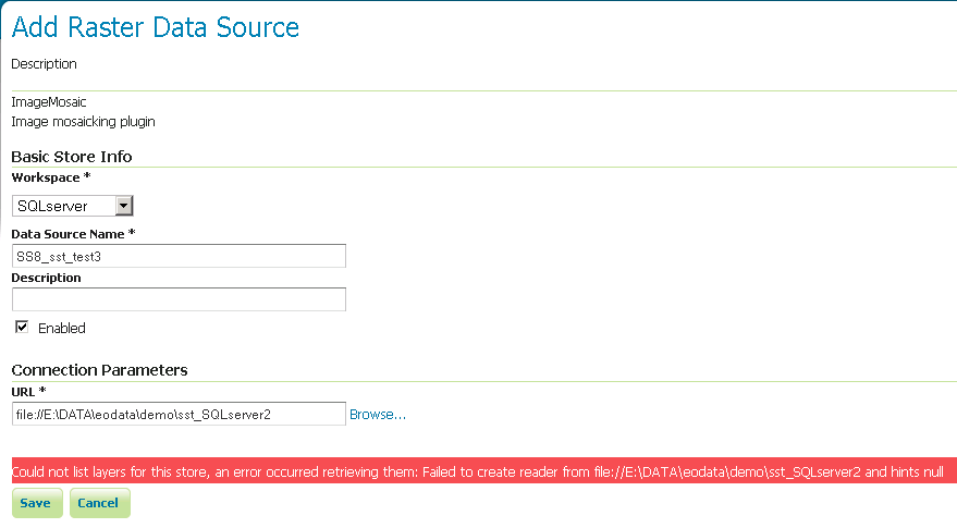

Hello,
And thanks for your tips. I tried this but failed:
"Could not list layers for this store, an error occurred retrieving them: Failed to create reader from file://E:\DATA\eodata\demo\sst_SQLserver2 and hints null"
I'll attach a screenshot, in case it makes a difference. I checked the database and to me it seemed that the proper table had been created with the appropriate data in it (fid, the_geom, location, time). So to me it seems the problem cannot be with database privileges etc. I switched another datastore.properties -file to the image folder (E:\DATA\eodata\demo\sst_SQLserver2 above) defining a PostGIS-database and clicked Save again: the datastore was created without problems. So something does go wrong with SQL Server.
I'll discuss this with my more database-wise colleagues and let you know if we can figure it out.

Hello all,
Today I had time to examine geoservers log file and there I found the following related to the image mosaic creation:
2014-12-02 10:29:25,989 WARN [gce.imagemosaic] - Unable to close indexingjava.io.IOException: Error occured calculating bounds for sst_SQLserver3
java.lang.RuntimeException: java.io.IOException: Error occured calculating bounds for sst_SQLserver3
  at org.geotools.jdbc.JDBCFeatureSource.getBoundsInternal(JDBCFeatureSource.java:529)
  at org.geotools.jdbc.JDBCFeatureStore.getBoundsInternal(JDBCFeatureStore.java:189)
Caused by: java.io.IOException: Error occured calculating bounds for sst_SQLserver3
  at org.geotools.jdbc.JDBCDataStore.getBounds(JDBCDataStore.java:1264)
  at org.geotools.jdbc.JDBCFeatureSource.getBoundsInternal(JDBCFeatureSource.java:522)
  ... 147 more
  at org.geotools.data.sqlserver.SQLServerDialect.decodeGeometry(SQLServerDialect.java:576)
  at org.geotools.data.sqlserver.SQLServerDialect.decodeGeometryEnvelope(SQLServerDialect.java:600)
  at org.geotools.jdbc.JDBCDataStore.getBounds(JDBCDataStore.java:1250)
  ... 148 more
Caused by: org.opengis.referencing.NoSuchAuthorityCodeException: No code "EPSG:0" from authority "European Petroleum Survey Group" found for object of type "IdentifiedObject".
  at org.geotools.referencing.factory.AbstractAuthorityFactory.noSuchAuthorityCode(AbstractAuthorityFactory.java:951)
  at org.geotools.referencing.factory.PropertyAuthorityFactory.getWKT(PropertyAuthorityFactory.java:316)
  ...160 more
And true enough when I checked the database, even though the image geometry itself seemed to be created correctly in SQL Server table, it lacked SRID. Just in case, I also checked the image used for the creation of the data store with gdalinfo and to me it seems to be fine what comes to coordinate system (at the bottom).
So, can we just conclude that ImageMosaic plugin does not work with SQL Server or is there some workaround? I wondered about using a geometry metadata table but I couldn't find any way to make the plugin use that instead of the index table.
Kind regards,
Samuli

Regards,
Samuli
