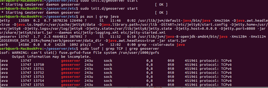

When I run the command, I can see my Geoserver is started;
serb@anonymised.com:~/geoserver/etc$ sudo init.d/geoserver start
  • Starting GeoServer daemon geoserver
Inline images 1
The problem is testing the geoserver; I can not see it. Jetty is working on 8080;
From /home/serb/geoserver/etc/jetty.xml ;I change the port to 80 as well.
Still, I can not see geoserver running and don’t know how to test on my browser .

Serb,
What version of GeoServer did you install? The version mentioned on the blog is very old. Recent GeoServer has been upgraded to be compatible with the Jetty 9 we include in our bin.zip download, but the Jetty 8 you are using should work as the big Jetty changes happened in I think Jetty 7.
Do you see any errors in the jetty logs?
Your geoserver data directory is inside your home directory. Great care must be taken to grant the geoserver user access to this directory, and this can cause other permissions problems. I strongly recommend placing the GeoServer data directory in a system directory and setting the permissions as described in the blog post.
