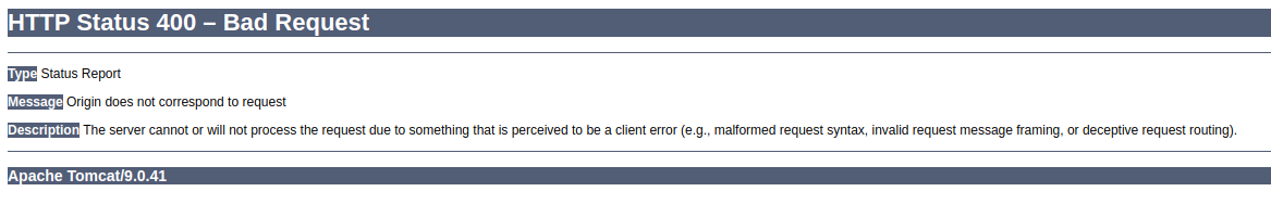

I have a geoserver running in a Kubernetes cluster. The ingress is configured with the following rule:
spec:
rules:
- host: stage.***
http:
paths:
- backend:
serviceName: geoserver
servicePort: http
path: /geoserver/
The site works well, but any submissions result in a 400 bad request without any log from the geoserver. For instance clicking on the PostGIS link when adding a New Datasource results in the following message:
Any idea?
Thanks
Hi Helge,
You may need to configure the proxy URL: https://docs.geoserver.org/stable/en/user/configuration/globalsettings.html#proxy-base-url.
GeoServer uses info about its hostname to generate responses and webpages. If GeoServer doesn’t know what it ought to report its URL as, then things go poorly.
Cheers,
Jim
